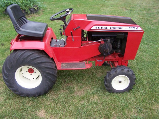

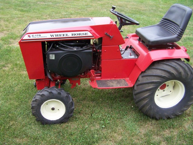

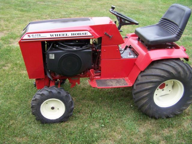

546cowboy 302 #2 Posted April 19, 2013 I had some on a C-175 and they will not fit without raising the seat pan about an inch and a half. Then you will have a problem with the tires hitting the foot rests. The best way to do that is shorten them about an inch at the rear so it won't be as easy as it looks. They look good in the attached pictures but they were too much trouble since I didn't shorten the foot rests just bent them some. Share this post Link to post Share on other sites

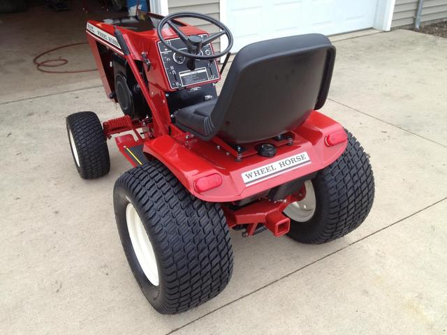

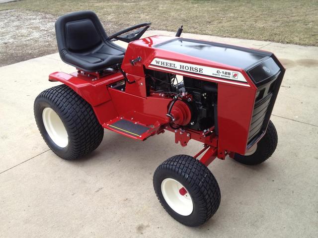

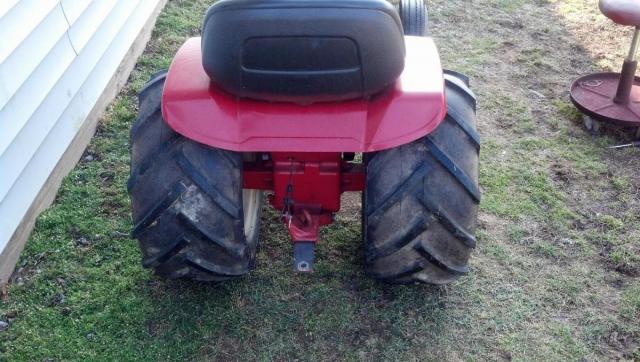

Martin 2,134 #13 Posted April 20, 2013 if you want the 12 x 12 but are willing to come down on your overall diameter...... 24 x12 -12 looks great on the 12 x 8.5 rims on a c series in my opinion........ 5 1 Share this post Link to post Share on other sites
Trouty56 568 #14 Posted April 20, 2013 Dang Martin....that 125 is NICE!!! I like the tires too..... 1 Share this post Link to post Share on other sites

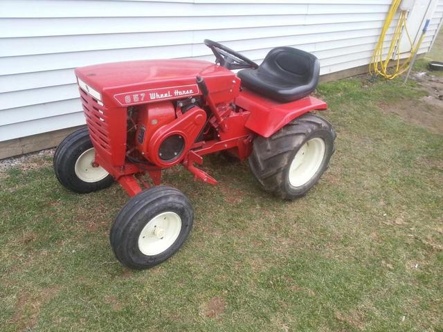

tractornut86 622 #15 Posted April 20, 2013 Being a 8hp tractor a pair of 23x10.50 would look nice. Here is my 857 with 23x10.50 on john deere rims. 1 Share this post Link to post Share on other sites

bean 85 #18 Posted April 21, 2013 if you want the 12 x 12 but are willing to come down on your overall diameter...... 24 x12 -12 looks great on the 12 x 8.5 rims on a c series in my opinion........ IMG_1888.JPG IMG_1889.JPG I love the 24s. I had those same carlisle tires on my old tractor and they do a nice job on grass. Being a 8hp tractor a pair of 23x10.50 would look nice. Here is my 857 with 23x10.50 on john deere rims. I have a 310-8 with 23s. they do look good. just thinking of trying something different. Share this post Link to post Share on other sites
