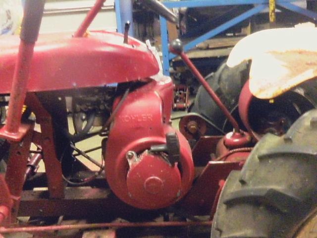

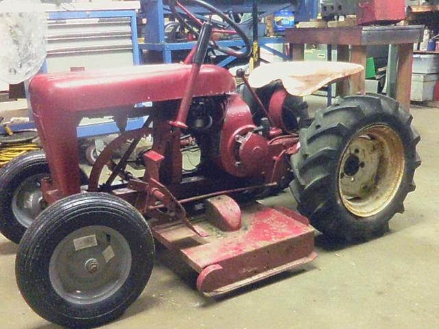

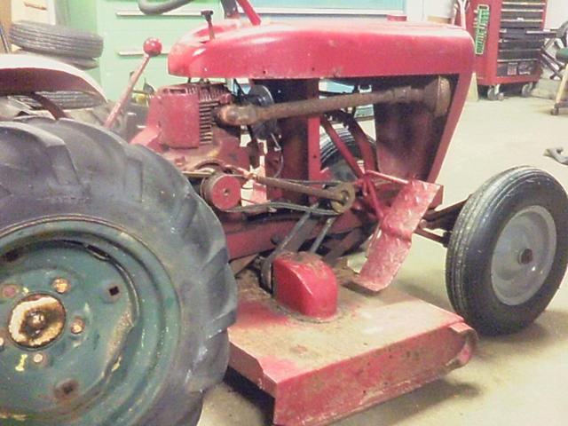

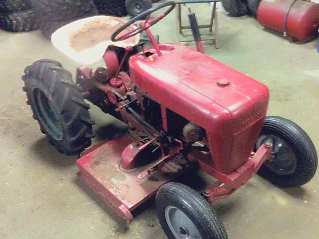

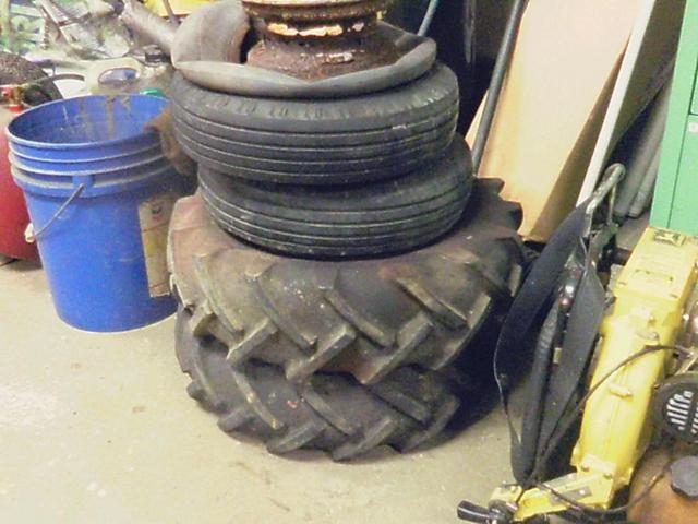

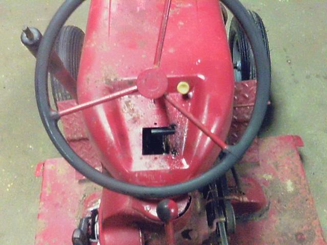

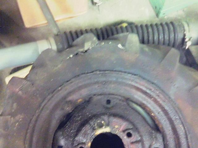

Luke 9 #1 Posted April 13, 2013 My nine year old boy and I bought a Wheel Horse at a local auction for $300 (after taxes and fees) about a week ago. It was his first auction, and he was fascinated with the experience. He sat on the tractor the entire bidding process like he already owned it. At the time, I knew nothing about Wheel Horses. We liked that it looked like a miniature tractor, and not a riding mower. I liked the small side shaft Kohler. After some internet research I figured out it was a 1960 Suburban. It included an attached belly mower, and seemed complete at the auction. I later learned, the belt and exhaust shields are missing. It is also missing the air cleaner and filter. The note on the hood at the auction said "good engine and trans". Well, the carb was frozen solid. It had red paint all over it and crap inside it. I hate it when people spray everything with paint, even if it's not supposed to be painted, just to make it look "good". We had to rebuild the carb. We did get the engine to start, but still need to adjust the carb to keep it running. We did not have the engine running long enough to try the transmission, but should soon. The rear tire had a hole in the sidewall, but Dad had a set of correct size rear tires behind his garage. He has had them for years. He didn't know what the were for, but kept them anyway. One front rim is rusted clean through. I have a cheap set of Tractor Supply wagon wheels on the front, until I can source a suitable, correct replacement rim. We needed to be able to roll it around while working on it. The throttle cable and lever is there, but the choke cable and lever is missing, along with the indicator plate, It also does not have the optional fenders. Previous sales on eBay have sold Suburban parts for around a $100 a piece. Well that adds up quick, especially on a $300 tractor to begin with. I saw what looks like a 61 Wheel Horse on Craigslist, and considered buying it just for the front wheels, fenders and the one belt guard it had. I'd then sell the rest to try and recoup the difference. But, my wife thinks spending $450 for another tractor, just to pull parts off it, is not a good idea. She is probably right. She wants to spend money on redoing some rooms in our house, which desperately need it. I'll post some pictures soon. We plan to get it running and driving first. Then I plan to completely disassemble it and paint each piece separately. I want it to look better than factory new. It would be nice for my boy to drive it around the tractor show. We don't plan to add any attachments beyond the mower deck, I would like to find the belt guards, exhaust shield, air cleaner, throttle plate, and front rim. We do have some metal bending machines in Dad's garage, so we may make the shields if I cannot find them. Safety first, especially with a kid on it. I would also like to find the optional rear fenders and a front weight box. I read that these "nut roasters" can flip due to lack of weight up front. Any help with cross reference part numbers, interchangeable parts, production numbers and suggestions would be appreciated. The replacement parts don't have to be "numbers matching", but should look like they belong on the tractor. The majority of the early Wheel Horse tractors I've seen, have metal seats with Swiss cheese style holes in them. My seat is solid, without the Swiss cheese style holes. Can anyone tell me why? Was it a one year thing; a dealer thing, a supplier thing, or just a replacement seat? Luke NJ 1 Share this post Link to post Share on other sites

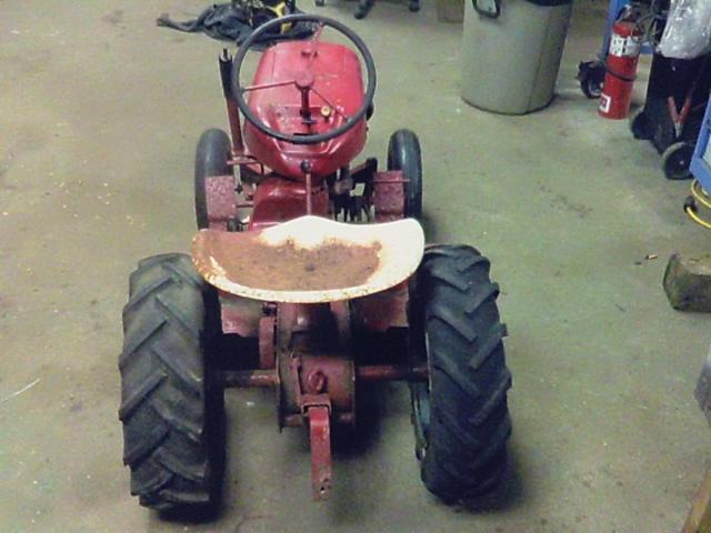

VinsRJ 724 #3 Posted April 14, 2013 Sounds like a nice project! As for the seat... during the transition period of 1959 into 1960 model, WH did use a solid seat pan. From time to time you will find a late model 59 RJ with a solid seat pan and then again you will find a early 60 Suburban with a solid seat pan. Share this post Link to post Share on other sites
Jake Kuhn 1,600 #6 Posted April 14, 2013 Very nice looking horse! That is way nicer than my 401 was, but it did run and drive. Looks like you have just about everything there, other than what you said. New air filter assemblies can be bought for around 50 bucks. And if you want a reproduction belt guard or heat shield a belt guard is 50, and a heat shield is around 25. If you are interested in finding more about these parts send me a pm. ~Jake Share this post Link to post Share on other sites

KC9KAS 4,746 #11 Posted April 14, 2013 ,and thanks for the photos. I know you put some wheels on just so you could move it around, but the right rear tire is backwards. Share this post Link to post Share on other sites
wallfish 20,724 #12 Posted April 14, 2013 You can find rims on anything that uses 4.80x4x8 tires. I found a nice set from a yard cart. Some of the bores may be a little short but you can shim them to fit, some may be to long, I used a small pipe cutter to shorten them. The belt guards are the same for 1960 400,500 and 1961 401,551. The same for the tool box and fenders plus RJ-58/59. Yes, all nut roaster fenders will fit You can try sending a PM to member rwilson, he was making reproduction throttle/choke levers for the 400 but not sure if he still has any more. That's a nice find. At least the hood isn't hacked too bad. The original throttle/choke levers fit in the square hole and are a single piece, then they are covered by the ID plate. Looks like someone cut a little around the hole to make what they had fit. Another member here was making repros of the ID plates but again, I'm not sure if he still makes them or not. Share this post Link to post Share on other sites
Luke 9 #13 Posted April 14, 2013 ,and thanks for the photos. I know you put some wheels on just so you could move it around, but the right rear tire is backwards. I have two good left side rear wheels, and two right side rear wheels that need work, hence the one backwords wheel. I could say i did it on purpose to help backing up, but the truth is, I am waiting till I'm ready to paint to remove the tires and correct them. Share this post Link to post Share on other sites

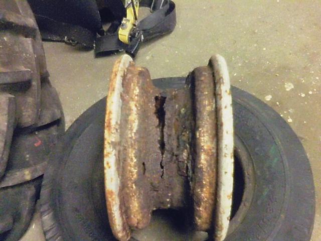

RThomas 1 #18 Posted April 14, 2013 Luke, check out my 1960 Suburban 550 I posted last week. It's in another thread from earlier. I'm working on getting new rims as mine rusted clear through also. What are you using for your front rims right now? And what are you gonna eventually use? Ron Share this post Link to post Share on other sites
Luke 9 #19 Posted April 14, 2013 Luke, check out my 1960 Suburban 550 I posted last week. It's in another thread from earlier. I'm working on getting new rims as mine rusted clear through also. What are you using for your front rims right now? And what are you gonna eventually use? Ron The front wheels are from Tractor Supply. They are cart wheels, and are the same size tire. They are about $20 a piece for rim, tube, tires and bearings. They are good for rolling around, but will require spacers, and may not stand up to regular tractor use. Share this post Link to post Share on other sites
