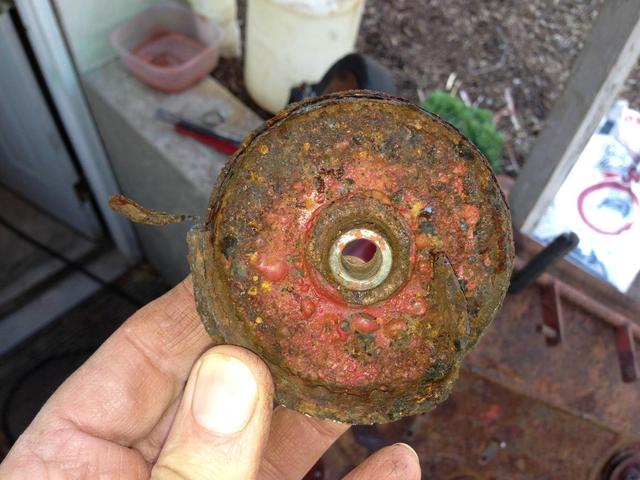

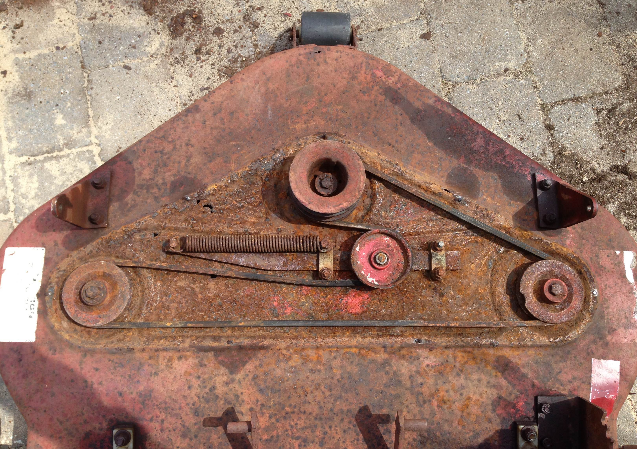

tombones49 3 #7 Posted April 15, 2013 My three spindles seem to be okay. There are no grinding sounds and the shafts do not seem to have any lateral play in them. Each spindle turns freely. Call me Mister Lucky ..... so far. Removing the pulleys is another story. The drive pulley is 4" diameter while the two outside pulleys are 3-3/8" diameter. The idler pulley is 3-1/4" diameter. The idler pulley is totally shot and I did get it off the deck. The drive pulley and one of the two outside pulleys are also okay. One outside pulley simply has a "nick" in the upper rim. Should I be concerned about the nick? Also, my spindles do not have a grease fitting. Permanently sealed spindle bearings? I cannot seem to find a service or repair manual. I do not know the brand of the deck, ( W.H. I think ), and certainly don't know the year. The tractor is a 1969 Commando V7 aka 1-4741. See photos attached. Thanks, Tombones 49 Share this post Link to post Share on other sites
can whlvr 994 #8 Posted April 16, 2013 i have tried using chipped puleys,they cut the belts up on me,so i had to get a new one Share this post Link to post Share on other sites
Don1977 605 #9 Posted April 16, 2013 If you taper the inside edge of the chipped place it should be OK to use. Those are cast iron pulleys I have used one with a similar chipped place with out any problem. Take the slide out and sand all the rust off so it can keep the belt tight. Share this post Link to post Share on other sites
gwest_ca-(File Mod) 11,888 #10 Posted April 16, 2013 This deck has the blades turning counter-clockwise. 1969 deck model number 5-7361 1970-1971 deck model number 5-7362 1972 deck model 5-0610 - here is the manual for this one http://www.wheelhorseforum.com/files/file/1717-mower-rotary-36in-rd-1972-5-0610-om-ipl-a-5284pdf/ The blades are no longer available from Toro and not aware of anyone else ever supplying them. Garry My three spindles seem to be okay. There are no grinding sounds and the shafts do not seem to have any lateral play in them. Each spindle turns freely. Call me Mister Lucky ..... so far. Removing the pulleys is another story. The drive pulley is 4" diameter while the two outside pulleys are 3-3/8" diameter. The idler pulley is 3-1/4" diameter. The idler pulley is totally shot and I did get it off the deck. The drive pulley and one of the two outside pulleys are also okay. One outside pulley simply has a "nick" in the upper rim. Should I be concerned about the nick? Also, my spindles do not have a grease fitting. Permanently sealed spindle bearings? I cannot seem to find a service or repair manual. I do not know the brand of the deck, ( W.H. I think ), and certainly don't know the year. The tractor is a 1969 Commando V7 aka 1-4741. See photos attached. Thanks, Tombones 49 Share this post Link to post Share on other sites
