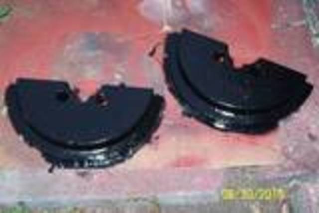

GlenPettit 1,719 #3 Posted April 12, 2013 Wheel Horse dealers could sell "Inside Rear Weights", the factory did not make them or list them, it was up to the individual dealers. There are a 1/2 Round pair of weights per wheel, each weighing about 25# each or 50# per rear wheel, two bolts holding on each half-weight. xx Share this post Link to post Share on other sites

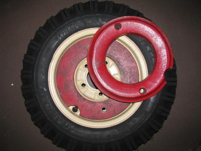

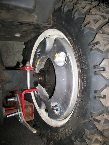

Sparky-(Admin) 26,686 #4 Posted April 12, 2013 Find a set of IH weights like these I put on the inside of my rim. There are official WH weights on the outside. Gives me 75#'s per wheel. Mike............. Share this post Link to post Share on other sites

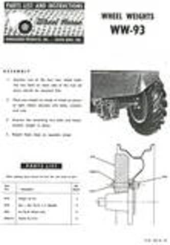

marreque 218 #5 Posted April 12, 2013 i belive 953's, 1054's and GT-14's all had inside wheel weights. i know my 1054 has them. For some reason i think the WH part number is WW-93 Share this post Link to post Share on other sites

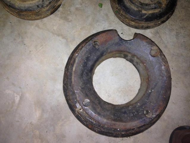

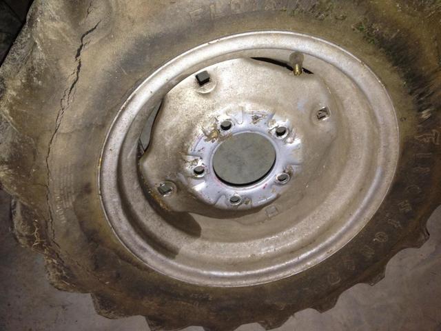

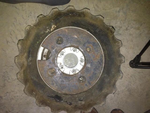

leeave96 496 #8 Posted April 13, 2013 Might have the answer under my nose. Pulled the ag tires off my 314-8 and cast iron wheel weights. I believe I recall these are Wheelhorse weights too - at least that's what I thought when I paid FULL price years ago - LOL Here is the back side of the rim: Here is the wheel weight: Here is the wheel weight setting on the rim: Note the cut-out in the weight for the valve stem. Also, I always thought it odd that the wheel weight did not fill-up the depth of the rim - when mounted on the outside of the rim. On the inside of the rim, it looks like a glove fit. Question is - will the hole in the weight fit over the hub. It measures a very close fit. Anyone have a set of this style wheel weight they are using on the inside of their wheels? The goal here is to get the weight to the inside of the tire so the hub cap can be installed. Thanks! Bill Share this post Link to post Share on other sites
Sparky-(Admin) 26,686 #9 Posted April 13, 2013 I say bolt it all up (inside and outside weights) and install them on your tractor and see if you have any issues. I bet it works out just fine for ya. Mike........ Share this post Link to post Share on other sites

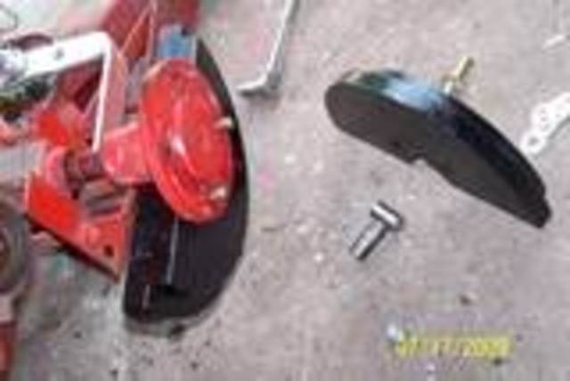

Lane Ranger 12,161 #10 Posted April 13, 2013 (edited) The 953/1054, 1054-A, and GT 14 could use the WW-93 Wheel Horse wheel weights . They were two halves and set in the inside of the 15 inch wheel on these tractors . Bolts went from the inside to the outside and lug nuts on the outside of the wheel heald them in place. We have two sets on 1054's. I will try to post some phtos later but I beleive the WW-93 Manual in in the Red Square list of attachment Manuals on this site and in the Implments photos on this site. Edited April 14, 2013 by Lane Ranger Share this post Link to post Share on other sites

WheelHorseSteve 56 #12 Posted April 15, 2013 Might have the answer under my nose. Pulled the ag tires off my 314-8 and cast iron wheel weights. I believe I recall these are Wheelhorse weights too - at least that's what I thought when I paid FULL price years ago - LOL Here is the back side of the rim: IMG_0882.JPG Here is the wheel weight: IMG_0884.JPG Here is the wheel weight setting on the rim: IMG_0886.JPG Note the cut-out in the weight for the valve stem. Also, I always thought it odd that the wheel weight did not fill-up the depth of the rim - when mounted on the outside of the rim. On the inside of the rim, it looks like a glove fit. Question is - will the hole in the weight fit over the hub. It measures a very close fit. Anyone have a set of this style wheel weight they are using on the inside of their wheels? The goal here is to get the weight to the inside of the tire so the hub cap can be installed. Thanks! Bill Yup! I have them on both tractors... they are awesome. 65 or so pounds on the inside of each wheel... which means I could easily top 120 lbs / wheel if I ran outside weights too. For the hub to fit you may need to do a little bit of grinding on the casting imperfections... it doesn't take much, but smooth out the inside to ensure you don't have interference. It's a tight fit! Share this post Link to post Share on other sites
