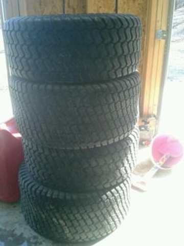

Don1977 606 #5 Posted April 12, 2013 I have 23-10.5-12 0n 7 inch rims they round up on the tread if you run 20 PSI in them. This picture as in 1989 when I put them on. They still look just about the same. 1 Share this post Link to post Share on other sites

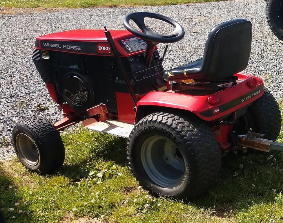

kpinnc 19,063 #19 Posted May 16, 2021 10.50 rear tires will work fine with 7.5 rims- if they are turfs. Maybe 2 ply cleats, but the better ones are 4 ply minimum. That makes them very stiff across the cleats. 10.50 on my 7.5 rims in the pic. 1 Share this post Link to post Share on other sites
