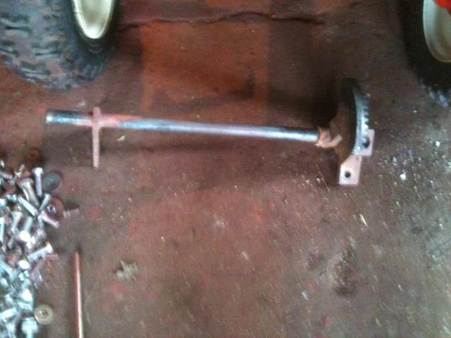

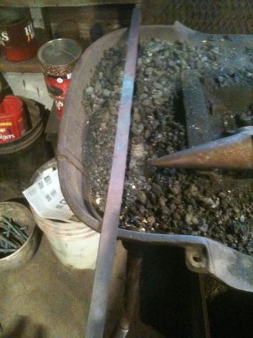

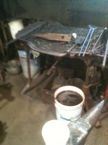

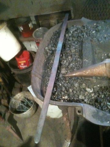

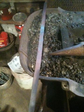

Lane Ranger 12,071 #1 Posted April 11, 2013 I have been working with my dad and bother the last two days on some of Wheel Horse tractors. My dad Clifton Ralph , who is a long time blacksmith, and my brother worked on two Wheel Horse parts yesterday that we needed for tractors. The first is a bar 1 inch wide, 1/4 inch thick our of 4140 steel (a better qualitiy than most of the attachment steel used in Wheel Horses) for my LMR 307 Front Reel Mower. This bar will have a bend on the end and two holes for 1/4 inch bolts that is used to lift the reel mower by the lift handle of the tractor. The other end is attached to the reel mower lift. We have not finshed the part yet but we will today. The other project was to extend the fan gear rod for a Lawn Ranger that David is placing an 8 HP Kohler motor on. He needed antoehr half inch for the battery box to fit in that space between to motor and the steering fan gear brace that attaches to the frame. Dad figured the steering fan gear rod could be extended 1/2 inch by heating and tappering the rod. So that is what we did and the steering road fits perfectly and meshes with the steering wheel gears fine. We also placed two new Carlisle trailer tires on our Wheel Horse hauling Ravens trailer. And finally, a little more work completed on David's 633 Wheel Horse project. We got the recoil installed and working fine. Adjusted the carb and placed a fuel pump on the 8 HP Kohler we have on this tractor. 3 1 Share this post Link to post Share on other sites
312Hydro 474 #2 Posted April 11, 2013 It's always great to have the proper tools and especially handy when someone knows how to use them. Stretching the rod would have never occurred to me and it's a great solution. i don't know of anyone having their own Blacksmith in the family. Very nice work! 2 Share this post Link to post Share on other sites

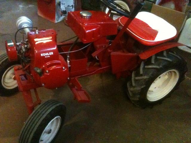

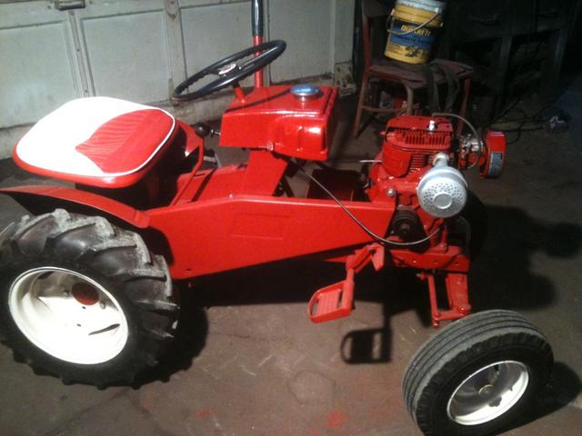

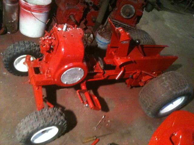

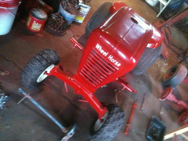

Lane Ranger 12,071 #6 Posted April 11, 2013 A few more shots of David Ralph's 633 Wheel Horse project: 2 Share this post Link to post Share on other sites
AMC RULES 37,259 #7 Posted April 11, 2013 Looks great Lane...I think Dave will need some custom decals made up for that new "833" of his. 1 Share this post Link to post Share on other sites

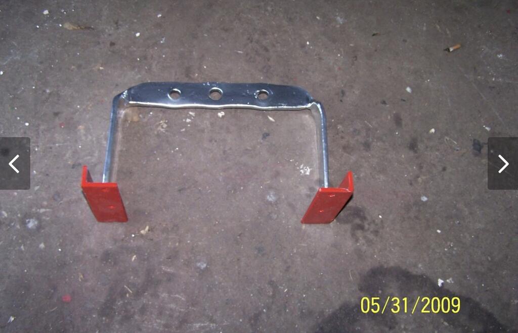

Lane Ranger 12,071 #13 Posted July 19, 2024 This works great on the 953/1054 tractors. Your slot hitch can stay on and be used in conjunction with the drawbar. Dad made three of these years ago! 1054 drawbar hitch Homemade (made by Clifton Ralph blacksmith Gary, Indiana) rear drawbar hitch for a 1964 Wheel Horse 1054 tractor. Hitch attaches to the rear snowplow piece located on the rear axles. This hitch allows you to have a ball, a clevis and a pin for slot hitch attachments. 1 2 Share this post Link to post Share on other sites
Handy Don 17,198 #14 Posted July 19, 2024 On 4/11/2013 at 9:18 AM, Lane Ranger said: Dad figured the steering fan gear rod could be extended 1/2 inch by heating and tappering the rod. So that is what we did and the steering road fits perfectly and meshes with the steering wheel gears fine. That is one sneaky/clever/amazing idea and cool execution! 1 1 Share this post Link to post Share on other sites
