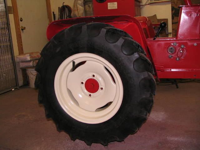

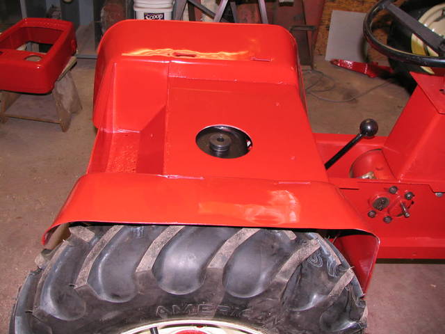

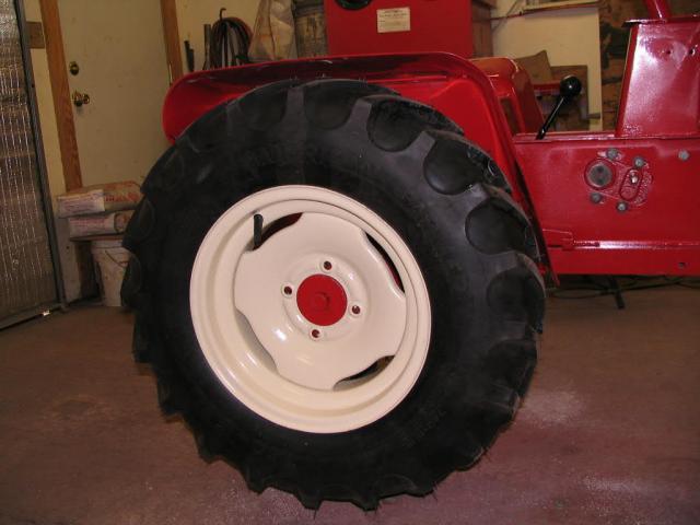

pacer 3,181 #1 Posted April 8, 2013 (edited) I recently posted about where I could find 'Ag' tires (always called them 'tractor' tires!) or even turf tires in 15" sizes that would fit my newly acquired 1054, and was given a couple leads... I ordered a couple of 5.00-15 and when they came in it was quickly apparent that they would look very odd on the 1054 being much to 'skinny' - The shipper graciously agreed to take them back thankfully. I then decided to try the 7.60-15s from "Stop and Go Tires" - http://stopandgotires.com/modelsize.asp?ProductCode=%27FA512%27 knowing they were a good bit larger than the 6.40 -15s that was originally on the tractor - from to skinny to too fat?? They were shipped promptly and on arriving I anxiously set one of them beside the tractor -- hmmm, they are big! Couple days later I was able to get them and my rims down to the tire shop and mounted, again anxiously getting home and sitting one on the axle to see how it fit up...well they are a fender full, but theres about 1/2 - 3/4" clearance on the front edge and maybe 3/4 - 1" on the top, the height of the tire on rim with air is exactly 30" - and by golly I like that agressive look! and we dont have springs to contend with Thought I would post these pics to give other owners of the models that take 15"'ers an idea of the way they look on on a tractor and be better aware of the size - you know "a picture is worth a ......" (edited to add height of tire) Edited April 9, 2013 by pacer 2 Share this post Link to post Share on other sites

pacer 3,181 #7 Posted April 9, 2013 OK guys, I should have included the height of the tire in my first post since there are other models affected here and this is a vital piece of info, so I checked the measurement --- The height of this 7.6-15 tire on the rim aired up is exactly 30" Share this post Link to post Share on other sites

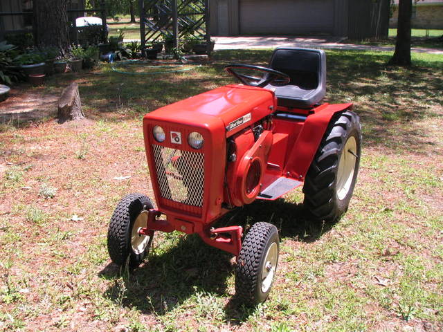

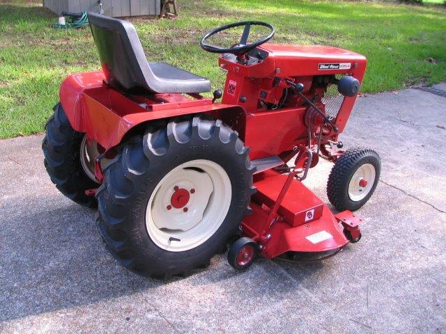

pacer 3,181 #13 Posted October 2, 2014 I dont have a pic from the rear - these 2 are the best I came up with. I dont have the tractor anymore - had to make room for other horses! Share this post Link to post Share on other sites
