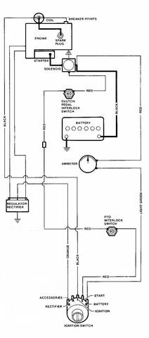

rmaynard 17,659 #4 Posted April 5, 2013 Do you have a good wiring diagram to trace all of your circuits? Share this post Link to post Share on other sites
WHnovice 2 #5 Posted April 15, 2013 I only have the disconnected wiring diagram from the Toro site. I swapped out he coil with C-85 I have and still have no spark when I jump the solenoid enen though it cranks. WHnovice Share this post Link to post Share on other sites
WHnovice 2 #6 Posted April 15, 2013 I do not have power on the ignition side of the solenoid when the ignition switch is in the run or start position. I Share this post Link to post Share on other sites

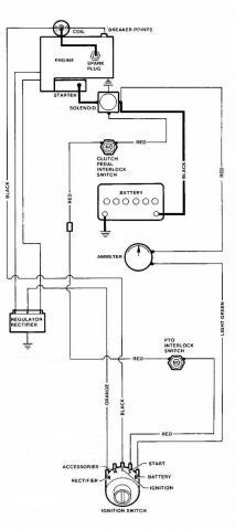

rmaynard 17,659 #7 Posted April 15, 2013 Here is the B-100 wiring diagram. Share this post Link to post Share on other sites
WHnovice 2 #8 Posted April 15, 2013 Thanks very much. I'll try and trace the circuits and determine where it is not working. I suspect the interlocks as it is difficult to depress the clutch pedel, turn the key and test the circuit. I should be able to jump the interlocks If in fact I'm getting power out of the ignition switch. Thanks again. Share this post Link to post Share on other sites
WHnovice 2 #9 Posted April 15, 2013 I have bypassed the interlocks and the engine cranks when the key is turned to start, however, I still have no spark from the coil. Two different coils have the same result. Share this post Link to post Share on other sites
rmaynard 17,659 #10 Posted April 15, 2013 (edited) The interlocks would not prevent you from having voltage at the ignition coil. You need to check to see if you have +12V at the "battery" terminal of the ignition switch. Then check to see if you have +12V at the "ignition" terminal when you turn the key to "run". You should also have power at the ignition terminal when the key is turned to "start". If not, you have a bad switch. If you have power at the ignition terminal, but no power at the coil, then you have a bad wire or connector going from the ignition terminal to the ignition coil. Edited April 15, 2013 by rmaynard Share this post Link to post Share on other sites
WHnovice 2 #11 Posted April 15, 2013 I have power on the battery terminal at the ignition switch. When it is in the run position I have power to both sides of the coil and I have power on the points. The points open and close properly when the engine cranks. Bypassing the interlocks, the engine cranks when the ignitions switch is turned to start. Still no spark from the coil. Share this post Link to post Share on other sites
