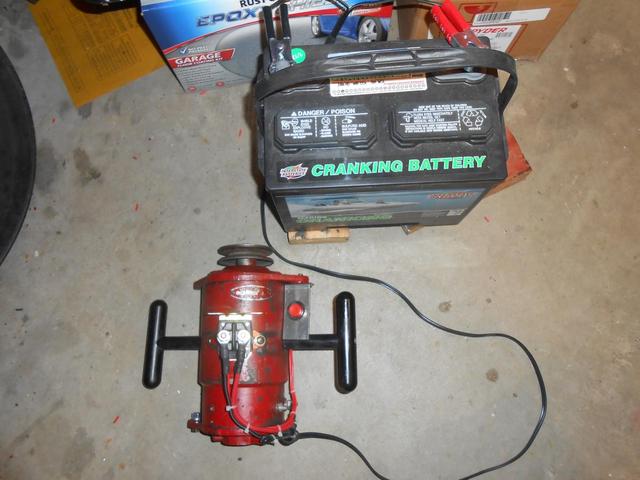

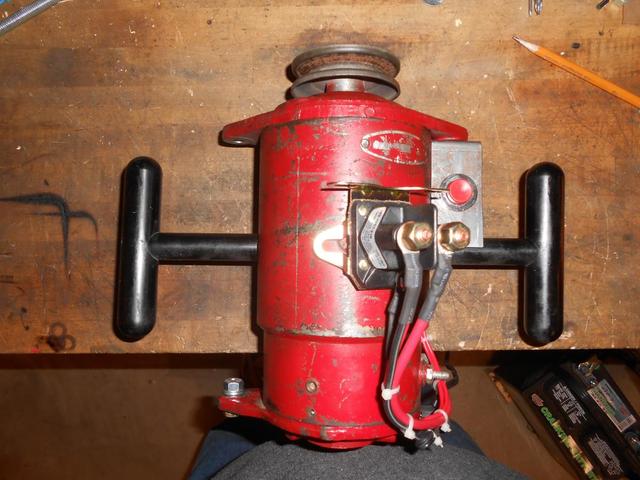

fireman 1,022 #1 Posted April 5, 2013 Ever since I got the Senior, I keep getting whipped in the face with the starter rope. The Wisconsin engine has long stroke and gives you a workout sometimes to start it. So I had a thought. Why not make something sot of like the guys use on drag cars. A hand held, battery operated remote starter. I got an old starter/generator from SteveBo. It didn't work and was missing the voltage regulator which I wouldn't need anyway. I picked up a new set of brushes for it and proceeded to pull it apart and clean and rebuild it. After that it worked great. Added handles, solenoid, push button and alligator clips with cable from an broken trickle charger. Now I can just stand next to the tractor with the starter and a long "V" belt and start the tractor. 4 Share this post Link to post Share on other sites

fireman 1,022 #9 Posted April 5, 2013 Went over to SteveBo's house today as he wanted to get his Senior out and test fit it in his trailer. We rolled it out of the garage and got it set to start. The starter wouldn't turn over the Wisconsin Engine. Then we realized why. The wire I used to connect it to the battery was not a heavy enough gauge. We hooked his jump box up to the battery side of the solenoid and the ground bolt. It turned the engine over no problem. One thing we did realize would be easier is to take off one of the handles and put a short pole in place of it. It does tend to get heavy. This way you can just put the bottom of the pole on the ground and against the bottom of the front tire and just hold tension with the upper handle. I will make the necessary changes and try it again. Share this post Link to post Share on other sites

dbartlett1958 99 #11 Posted April 6, 2013 I was wondering about the wire size when I first looked at your picture. Thought it looked a little small. We want a Video! Share this post Link to post Share on other sites
