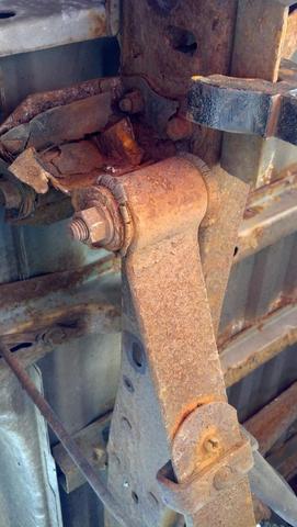

Well the weather man said it was to be sunny and 55 this past weekend here in Michigan so I planned to finally tackle the rear end swap on my 95 Ford Ranger.  Picked one up from a U-Pull junk yard about a month ago.

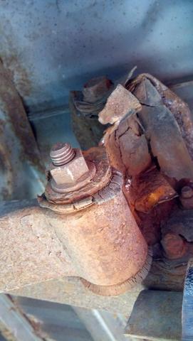

Get the back end of the truck up in air and the jack handle binds up so I can't release it.  So I set my jack stands and get a wrench.  Bust it loose and the truck drops violently onto the stands about 3 inches....  Boom, the rear shackles snap and the back axle falls to the ground, fortunately the wheels are still on.  Get the jack fixed, jack the axle back up put it on another set of stands while I get everything disconnected.  Pull the old axle out, and go to pull the springs, notice that the Previous owner had replaced the front spring hangers..  Pull whats left of the rear shackles and yup the rear shackle brackets are toast too.   Get out the grinder as the dang things are riveted on.  Did I mention I am doing this in my driveway.
Much hammering and grinding later end of day one, have one shackle hanger in place and it's 7:30 at night and I am sore as hell.....
To be continued...
It gets worse

i helped a buddy fix this a few years back. those trucks rust out bad.
his shackles broke, shock went through the bed, and the frame was close to rusting through. we welded up new parts for the frame and replaced most everything back there, even found a nice bed at the local junk yard.

Day two,  Raining decide to go back to bed and wait it out, get out side around 11:30.  Previous day had the O'lady take the springs to work(Sears Auto) to have the bushings pressed outta the springs go to put the new ones in and beat them like hell to get em in on the first, then on the second one I discover that when they pressed the old ones out it left the rusted fused outer jacket behind....  So I remove the remains with a chisel and whala the new ones slide right in.   Go get brake lines get home wrong size.. Back to the auto parts store.
Get the axle back under everything mounted up more hammering and sore arms.  Realize about 4:30 I haven't eaten since about 8:00 and I'm starting to get the shakes.   Get food, more beating and cussing broken bolts and stripped nuts..
Put brakes back together first side takes 1-1/2 hours to figure out :banghead: , second side takes 10 minutes :tools-wrench:
Go to put drums on and find out that at some point between 1995 and 2000 Ford decided to increase the size of the center hub by about 1/8 inch so the drums won't fit.  At this point it is 7:00 on Easter Sunday and everyone is closed.   So clean up go inside and eat Easter dinner around 8:00 PM and collapse onto the Lazy boy.
Wake up this morning gotta go to work so have the 17 year old stepson take off the drums and him and his mom take the drums back to Advance Auto.  They get home and put new, new drums on and wheels, then I get a call at work...
Wheel is wobbling and making a grinding noise :bitch::banghead: :banghead:
Long story short one of my rims is bent spare is on and Tracey made it to work.
Now I'm wondering if anything was actually wrong with the rear end and the bent rim was causing all the problems :bitch::confusion-scratchheadblue:

Had the bed off my 94 ranger a few years back..brake line let go, and was easier to take the bed off. While I was in there, the rear shackle was just about rusted off. Replaced them, and spray painted the frame, bed bottom etc. Looking at it now, you can't even tell I did anything,  It's all rusted out again. That road gel is killing everything. Dam it!!

Finally was able to take the truck to work this morning.  Man it rides like a new truck, of coarse it should the whole back end is new now :roll:
Oh yeah also the wheels wouldn't fit do to the hub size change so two hardened die washers on each lug stud fixed that right up.  Have to keep my eyes opes for a new set of wheels now.
