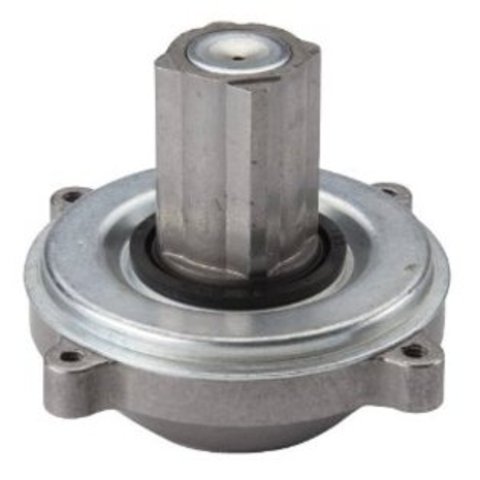

rmaynard 17,560 #11 Posted April 1, 2013 The part that is sticking out of the grass screen is this: This is a one-way clutch. A 7/8" socket will fit over it. Once the engine is running on it's own, the one-way feature prevents the drill from being yanked out of your hands as I stated above. Share this post Link to post Share on other sites

groundhog47 448 #18 Posted April 2, 2013 Just need to remember don't remove screen or if done put back in screws or starter clutch might come open and loose your little round thingys, yup I did that, want forget either! The part that is sticking out of the grass screen is this: 2012-03-25_210831_starter_clutch.jpg This is a one-way clutch. A 7/8" socket will fit over it. Once the engine is running on it's own, the one-way feature prevents the drill from being yanked out of your hands as I stated above. Share this post Link to post Share on other sites
