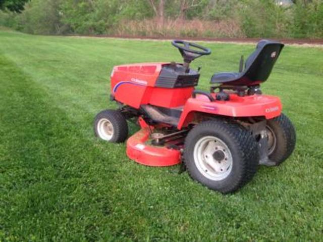

leeave96 496 #12 Posted July 22, 2013 Got the engine in the Simplicity. It was a bit more difficult putting the engine vs taking it out. I don't think the PO did a lot of maintenance as evidenced by the amount of grass I pulled out of the engine bay. It is oil soaked and the neglect is probably why the engine went bad. Here is a pic of the load of grass I pulled out: Here is a pic of the engine in the tractor: And a pic after mowing: The tractor has a 50 inch deck and I mowed heavy/thick/tall grass and the the 14 hp engine did a good job. It never bogged down, but sometimes I was into the governor. Under normal mowing conditions, I don't think this engine will break a sweat (the original engine was an 18 hp engine). If I had to describe the tractor in one word it would be "smooth". It is very quite, almost zero vibration, very tight turning radius. Being a Simplicity, the deck is ground supported, but with rollers across the back of the deck. The set-up is similar in most ways to a Wheelhorse. The rollers are supposed to help with scalping and give a stripe to the grass. I tried to stripe my lawn, but was somewhat disappointed that I got hardly any striping if any at all. Maybe I've got to much clover mixed in with the crabgrass... I can't say the Simplicity laid down any better cut than the Wheelhorse. Thanks! Bill Share this post Link to post Share on other sites
leeave96 496 #13 Posted August 4, 2013 A little striping with the Landlord... Share this post Link to post Share on other sites
