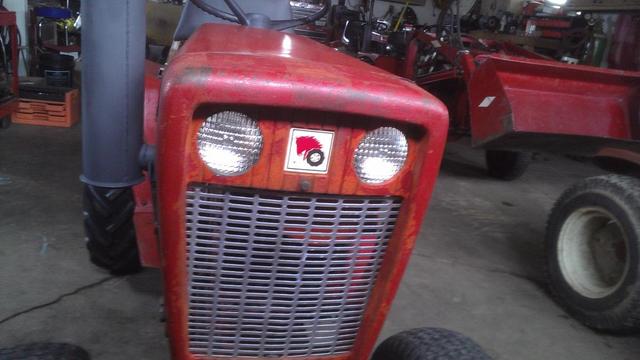

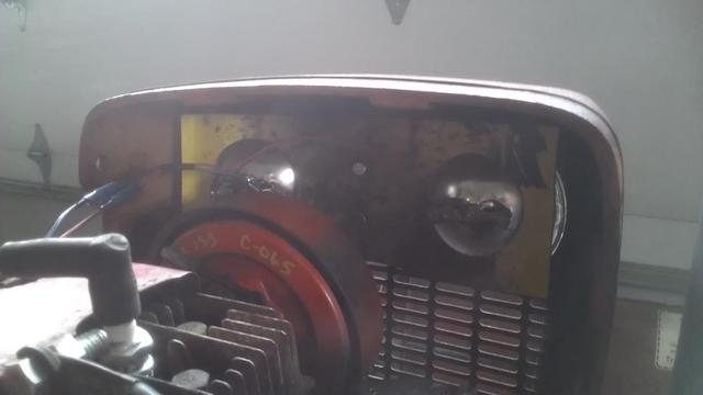

jeremi3210 743 #4 Posted March 30, 2013 I took glass headlights out of a newer tractor and made a bracket to sandwidge them in the grill. I will try to get pics soon. Share this post Link to post Share on other sites
jeremi3210 743 #5 Posted March 30, 2013 Ok got some pics. Let me know what you think of them. 2 Share this post Link to post Share on other sites
pacer 3,179 #6 Posted March 30, 2013 Aw Jeremi, so simple, so easy, so inexpensive -- the perfect KISS approach! I think I can handle doing an adaption like that easy enough! Thanks a million... Bill Share this post Link to post Share on other sites
