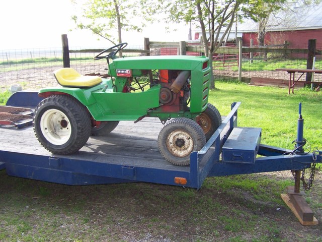

caseybgilbert 4 #1 Posted March 29, 2013 Well, now that my '82 C-195 is in proper working order, I began working on the '71 Bronco 14 Auto with the K321 today. This thing probably hasn't been cranked in 15 years. After replacing the battery and spending a couple of hours on prep work prior to turning the key, I was able to get it running. I didn't let it run more than 10 seconds...just long enough to ensure it gets fuel and spark sufficient to fire. Since I know it will run now, it is time to purchase some needed parts (I hate buying parts for an engine that has no hope of running!). The throttle and choke cables are frozen up, carb leaks fuel, etc etc. I have ordered the throttle/choke cables, fuel petcock, carb gasket kit, and spark plug lead wire. That is all that I have noticed for now that definitely needs to be replaced. What are some things that I should definitely check out on this particular motor? The last thing I want to do is throw the rod or something like that because I failed to pay attention to a known weak point. I have read several times on this forum that the balance gears have a tendency to come apart and wreak havoc on the crankcase. What should I listen for to make sure they are doing ok? Since the only attachment I have for it is the tiller and it won't be used for work very often, I plan to actually do a partial restoration on it. Not a complete tear-down and rebuild but at least sandblast the sheet metal and give it a new finish with new decals, etc. Mainly to just keep it from rusting away. Here is a picture of it as of now. Don't judge on the condition of the shed. This is where it has sat for the past 15 years. Share this post Link to post Share on other sites
Trouty56 568 #2 Posted March 29, 2013 You sure you want to sand blast that?? Get the coating of dust off that and it will be a fine looking machine...... Share this post Link to post Share on other sites

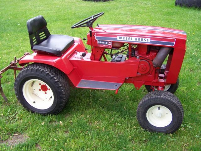

546cowboy 302 #3 Posted March 29, 2013 (edited) I can't see from that picture just what kind of shape the tractor is in. Personally I don't sand blast the paint off. I use aircraft paint stripper for paint removal and do blast the really rusty stuff. But I do feel better about one I've worked on when it looks good too. I'm not a purest who believes it should look original with years of patina on it. Here is the Bronc 14 I did several years ago. Wish I would have known I could get $450 for that seat. Edited March 29, 2013 by 546cowboy Share this post Link to post Share on other sites
Trouty56 568 #4 Posted March 29, 2013 If you click the little image it gets real big..... Nice lookin Bronco Cowboy..... Share this post Link to post Share on other sites
caseybgilbert 4 #5 Posted March 29, 2013 Trouty, I would love to just give it a good shine and call it a day but the hood and dash support both have a considerable amount of rust that can't be seen in the picture. I'm afraid if I don't do anything about it, it will end up eating a hole in the hood. Share this post Link to post Share on other sites

caseybgilbert 4 #16 Posted May 3, 2013 Here are a few of pictures of the Bronco. Click on the thumbnails for a larger view. So far, I have replaced the throttle and choke cables, changed all fluids, new plug, new battery, tire slime in the original (I'm guessing) Wheel Horse Turf Saver tires, ,and lubed all of the points. I ended up installing a new Walbro carb. I tried and tried to clean the original out with no luck. Even after multiple soakings in cleaner. The 'ole horse runs like a champ now. And, the tiller works! Can anyone shed some light on what this part is? I believe it would go along with a mower deck for the Bronco possibly? Share this post Link to post Share on other sites
