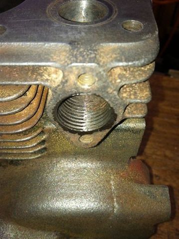

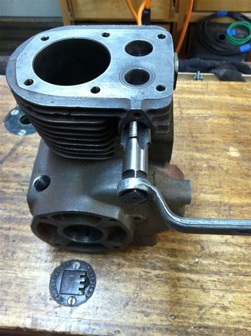

formariz 12,381 #5 Posted March 25, 2013 Kelly I have done quite a few. Very easy but on an assembled engine need to be carefull with shavings. besides plugging hole with a paper towel i keep taking tap out and vacuuming shavings often. Kind of important to go in as deep as possible since hole in engine is a bit oversize for 1/2"tap. Going in deeper allows you to have higher percentage of thread on high part of taper so there is less chance of stripping threads when tightening nipple. On an engine without the valve this is really easy since you can see tap bottoming out through port. Of course important to go in perpendicular to opening. Here are some photos of a K90 I just did. 1 Share this post Link to post Share on other sites
