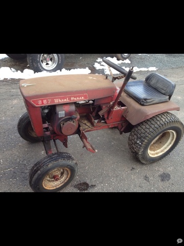

Xjchief 128 #1 Posted March 22, 2013 It's been sitting under a deck for prob 20yrs got a snowblower and deck with it. Anyone know where I can get new deck blades it's missing one.? Here it is Share this post Link to post Share on other sites
Sparky-(Admin) 26,272 #2 Posted March 22, 2013 I dont know my blade #'s but those who do will want to know what size deck is on it? I thought they came with 32" and 36" decks . Mike............ Share this post Link to post Share on other sites

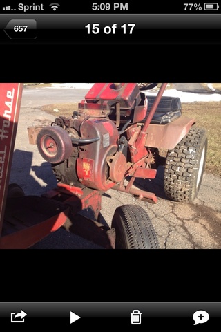

Xjchief 128 #3 Posted March 22, 2013 Here it is K ill check Share this post Link to post Share on other sites

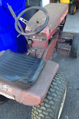

Xjchief 128 #4 Posted March 22, 2013 Also need a new steering wheel this model is 12volt right? Cus I have a 74c100 that is 12 Share this post Link to post Share on other sites

KC9KAS 4,746 #7 Posted March 23, 2013 I'm pretty sure that all are 12 volt. Share this post Link to post Share on other sites
GlenPettit 1,719 #8 Posted March 23, 2013 Take one of the blades into your local NAPA or Auto Parts store, they have a special "Power Equipment" catalog that has most everything for small engines and mowers in it, plus the blades. They can match the length (always measured diagonally) and hole size for you, and have it come in on their daily/weekly delivery, you don't have to pay that big shipping charge then, and they are usually give you best low prices for blades. Best to have all three blades identical, but I don't really think it would make a measurable difference, unless the other two are really worn bad. The best blades to get are the "Gator Blade" series, much better "throw" and smaller clippings, and don't cost much more (google it). Probably need new belts (WH numbers): 657 Drive Belt - #9691 (1/2" wide, 5/16 thick, 70" long) WH Mower Blades: 32" *327 -- #8777, 36" *367 -- 8014, 42" *426 -- #100200 Spindle Drive Belt: #1578 (3/8 wide, 7/32" thick, 39" long) Mower Drive Belts: RL367 -- #1587 (43"), and RM327 or RM367 -- #7430 (28") Always best to use the Wheel Horse/TORO belts, they have special angles = longer life, well worth the 15% premium. Share this post Link to post Share on other sites

Xjchief 128 #14 Posted March 23, 2013 Yea everything seems to be ok cleaned the carb gas tank needs some cleaning a lot of rust inside but nothing that can't b cleaned out then sealed with por15 tank sealer today I'm going to see if it runs. I want to do a new plug but napa said its a special order, it's a champion rbL12-6 any thoughts? Share this post Link to post Share on other sites

Kelly 1,038 #16 Posted March 23, 2013 On the blades that tractor would have came with a gear drive deck, it will have right and left blades so when your looking be sure to get the right side(correct) or buy a pair, the cutting edge will be on opposite sides. Share this post Link to post Share on other sites

KATO 115 #18 Posted March 23, 2013 If thats a 6hp Tecumseh HH60 (looks like it is) it should have a Champion RJ8C according to the Tecumseh Quick reference Here's a link to a spark plug cross reference otherwise. http://www.sparkplug-crossreference.com Share this post Link to post Share on other sites

Xjchief 128 #22 Posted March 23, 2013 I need a key for this so I can try to start it which one should I be looking for Share this post Link to post Share on other sites
