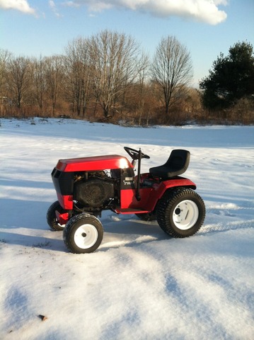

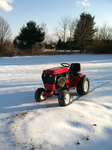

kaiser 100 #12 Posted March 20, 2013 Since y'all like pics here's a couple I just took out in the snowy wonderland. Share this post Link to post Share on other sites
can whlvr 994 #13 Posted March 20, 2013 looks good,decals will finish her off Share this post Link to post Share on other sites

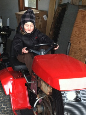

kaiser 100 #14 Posted March 20, 2013 Thanks, one more with the boy: He may be more excited then me! He's 3 and a half, calls it a trashkter. Lol 1 Share this post Link to post Share on other sites
chrisd200(inactive) 56 #15 Posted March 21, 2013 Very Nice Indeed. Can't beat sharing the horses with the younger generations!!!! Welcome to Redsquare!! Share this post Link to post Share on other sites
