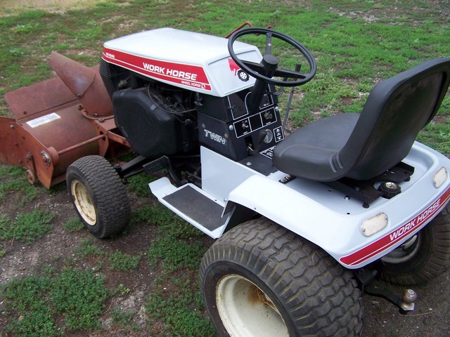

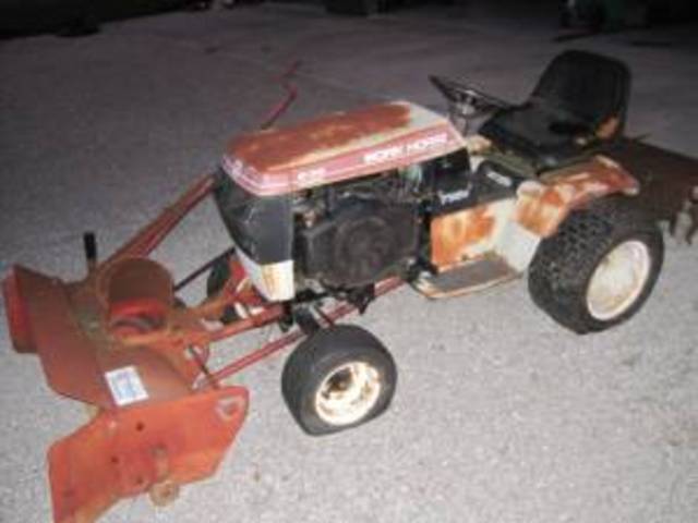

The one I did was a 1982 GT1848 and I mixed my own paint. I used Ford grey and some gloss white and some black to mix the paint. I just kept going back and forth until it matched the underside of the hood, which was the only place I could find the original color. I mixed about 8 oz. at a time. It came out pretty nice.
From this
To this
