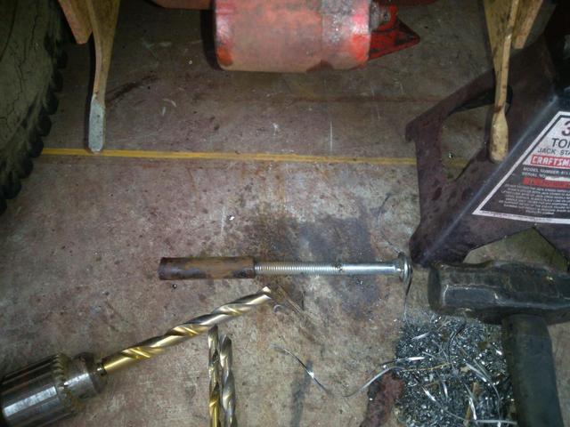

Trouty56 568 #1 Posted March 18, 2013 (edited) We've all had them....a hitch pin stuck in the tranny. Usually end up sawzalling the hitch off leaving the cut pin flush with the trans housing. I was talking to my son about his engineering class (way over my head in most cases) but one thing stuck in my mind. He was showing me how he can calculate the stretching of steel when pulled. So....I had this one pin in a 14 8 speed that I had cut as previously mentioned. I drilled a 1/2 hole through the core to all but maybe 1/2 inch from the end. I inserted a 10 X 1/2 inch bolt and whacked it out. My theory was that I was actually pulling the pin out decreasing the diameter ever so slightly instead of trying to push it out causing compression. I removed it from right to left thinking the larger tab would take the abuse better than the small tab. Well it worked......so it may be worth a try for somebody else too..... If this has already been covered previously just ignore this post.... Edited March 18, 2013 by Trouty56 5 Share this post Link to post Share on other sites

wheeledhorseman 579 #3 Posted March 18, 2013 The theory behind this is good and you've shown it works in practice so 10/10 for this post Bob. I've a pin in my 316 to do sometime so I suspect that this tip is going to come in handy and save a lot of time wasted getting nowhere, so thanks for posting.. Andy Share this post Link to post Share on other sites

KC9KAS 4,746 #7 Posted March 18, 2013 Thank you for the excellent pin removal idea! My biggest problem would be finding a good, sharp drill bit to use! You said you drilled a 1/2" hole.....Isn't the pin only 5/8" or is it 3/4"? You drilled most of the steel way before you started pounding! Still a really good idea. Share this post Link to post Share on other sites
Trouty56 568 #8 Posted March 18, 2013 (edited) You said you drilled a 1/2" hole.....Isn't the pin only 5/8" or is it 3/4"? You drilled most of the steel way before you started pounding! Still a really good idea. I started smaller like 5/16...then to 3/8.....then to 1/2...... The pin is 3/4. Thanks for the positive feedback....I hope it helps others. Wasn't too bad drilling. Total time was less than 1/2 hour. I have a set of Ryobi bits. Nothing special.... Edited March 18, 2013 by Trouty56 Share this post Link to post Share on other sites
