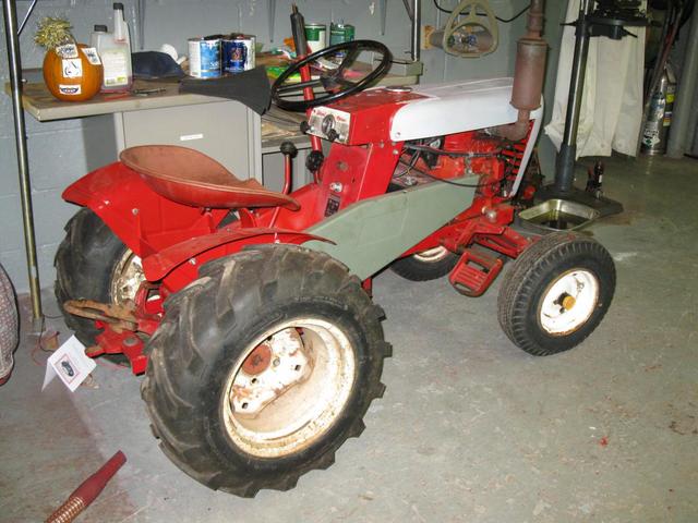

Thehunter 9 #1 Posted March 18, 2013 Hi All, I am a new member here, this is my first post. My name is Dave, and I live in Massachusetts. I recently bought what I thought was a 702 from a friend in the hopes of restoring it to its former glory. I found out it was actually a 704 after talking w/ a fellow member (gumshoes) and purchasing a 702 frame from him along with a few other parts. I'll be documenting my restoration here, I hope you enjoy the ride. This is my first WH, and I'm sure it will not be the last. EDIT*** Engine is a 753 (1963 model year). A little about the tractor... I bought it a few months ago, and it was in very solid mechanical shape. I actually plowed with it during the big blizzard we had this year. I stripped it all down last week, and started documenting what needed to be done. The rear transaxle mount had been welded at some point, so I started looking for a 702 frame. I bought one from Dave (gumshoes) and when I got home I realized it was different from mine... the front axle didn't fit. Further research indicated I a 753???, so I'll be building a 63 w/ a 62 frame and front end. here she is as i got her... during the start of the blizzard... getting stripped down... motor pulled... 2 Share this post Link to post Share on other sites

TT-(Moderator) 1,183 #4 Posted March 18, 2013 Dave! That tractor isn't 100% 702 and it is definitely not a 704. What I do see is a mixture of '62 and '63 parts, but without clear, close-up pictures, it's hard to tell exactly which parts from what year. Can you post more pictures of the hoodstand, gas tank, dash, etc.? Is there an ID tag on the engine? If so, could you post all of the numbers please? 2 Share this post Link to post Share on other sites

Mr. 856 170 #8 Posted March 18, 2013 sweet little rig. Yah I hope my "restoration" looks as good as yours did BEFORE you took it apart. Had it been painted prior to you taking it apart? Sure looks clean in those pictures. Share this post Link to post Share on other sites

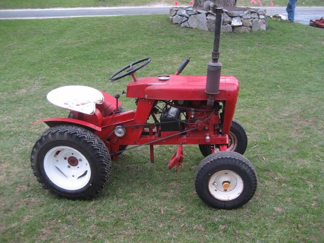

Ken B 3,203 #10 Posted March 18, 2013 Any idea if that tractor ever spent time in CT? Share this post Link to post Share on other sites
Ken B 3,203 #11 Posted March 18, 2013 I'm going to answer my own question, that tractor without a doubt spent time in CT Share this post Link to post Share on other sites
Thehunter 9 #12 Posted March 19, 2013 that's funny, the tractor did actually come from CT about 2 years ago. If that is my tractor, they PO must have swapped out tires etc, because alot of the parts are different than mine I can see. Muffler is different, hood has a large dent on the RHS, right clutch is missing, fuel filter is different... Share this post Link to post Share on other sites

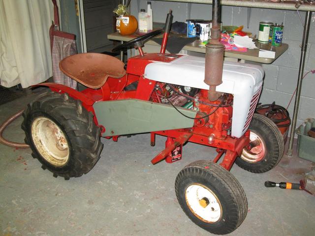

Thehunter 9 #13 Posted March 19, 2013 blood, sweat, and tears. that was the name of the game last night. I knocked the battery box off of the frame (it was rotted and thinned out) and when the last weld broke I drove a sharp broken corner directly into my thumb. closeup of the bloodshed below got the wheels and the frame over to the sandblaster today, too much work for a small cabinet... Share this post Link to post Share on other sites
Thehunter 9 #14 Posted March 19, 2013 a few asked for more pictures to try and determine the model year, i ran the engine cover numbers and the engine is definitely a 753... here's the tank here's the hood (bottom tab will need to be fabricated since it's broken off) Share this post Link to post Share on other sites
Thehunter 9 #15 Posted March 19, 2013 on the right side of the engine (looks like the camshaft bearing) there appears to be some chip out where it was pressed in at 3 o'clock. would this be a stress riser for a potential crack in the future? also, some of the fins near the exhaust are very "thinned out". is this common for a motor of this age? Share this post Link to post Share on other sites
