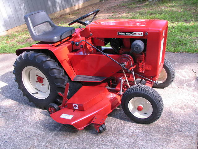

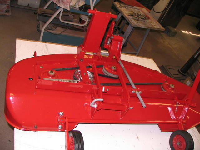

pacer 3,180 #9 Posted November 14, 2014 This is a 48" SD from a 1965 1054A that was from original owner stating the tractor was original. So yours is definitely later than 1965. But can easily see the heritage of the later models like you have, with WH adding improvements as time went along. One thing on this deck that was NOT good was the anti scalp "sliders?" - a piece of 1/2" round stock - on a turn they would plow up some dirt, so I added casters. This deck would also 'kick' to the back a little bit in lift mode and tighten the belt more, but had no problem with tire clearance (and those are some large tires!) Share this post Link to post Share on other sites
