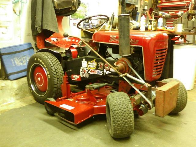

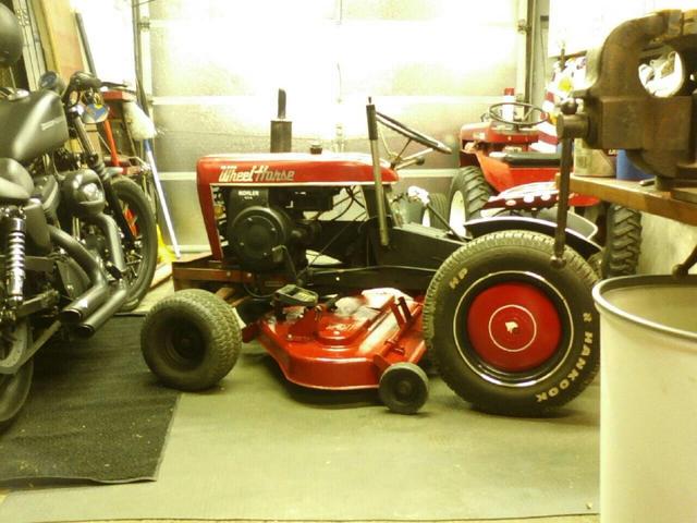

HorseWhisperer 243 #1 Posted March 13, 2013 I have completed the transformation from 67 Lawn Ranger to working suburban prototype.I have reconditioned a free 36" inch deck and cant seem to make it adjust level.Well only on the lowest setting( mohawk setting)I need little insight.I have adjusted the front bump stop in all positions.When I adjust the cutting height lever,only the back raises.How do I finish strong on this passionate philly? lol 4 Share this post Link to post Share on other sites

KATO 115 #5 Posted March 13, 2013 That looks to be a '71 or newer deck (5-0710 maybe)???? And not made to fit that tractor Obviously. It looks very similar to my 42 inch deck and it looks to be missing parts. Try this link http://www.partstree.com/parts/?lc=toro_consumer&mn=5-0710%2C+36%22+Side+Discharge+Mower%2C+1971&dn=A_5122-51220004-0001 Share this post Link to post Share on other sites
HorseWhisperer 243 #6 Posted March 13, 2013 That looks to be a '71 or newer deck (5-0710 maybe)???? And not made to fit that tractor Obviously. It looks very similar to my 42 inch deck and it looks to be missing parts. Try this link http://www.partstree.com/parts/?lc=toro_consumer&mn=5-0710%2C+36%22+Side+Discharge+Mower%2C+1971&dn=A_5122-51220004-0001 It is a new style deck,its complete but for the life of me the cut adjustment lever is suppossed to level the front too?Like most other wh decks?It works great in the lowest setting. Share this post Link to post Share on other sites

Marv 996 #13 Posted March 15, 2013 Horse Whisperer, Beautiful tractor. Regarding adjustment, Go to Toro parts viewer and look up model 5-0601, on the view look a index # 30. That is what you need to be able to adjust the front to rear relationship. Hope this helps. Marvin Share this post Link to post Share on other sites
HorseWhisperer 243 #14 Posted March 15, 2013 Thanks Marv! I Share this post Link to post Share on other sites
