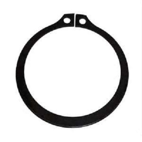

wallfish 15,972 #6 Posted March 10, 2013 The gearboxes that I have opened up use a snap ring / retaining ring that retains the shaft. Could that "lip" you are referring to be a snap ring? Share this post Link to post Share on other sites

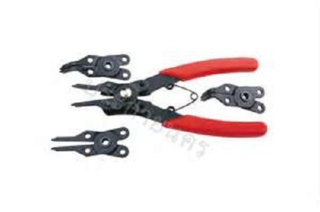

wallfish 15,972 #7 Posted March 10, 2013 OK, I went out to take a look at mine and it's the same type of Peerless gearbox I had opened up before. You will need to take the flat side plate off and work your way through all the grease to find the holes in the snap ring. An angled pair of snap ring pliers work best for spreading it open and the shaft will slide out through the ring, gear and bearing. You may want to replace the seal too since you are already in there. If the bearing is shot, it probably ruined the seal too. Here's a cheap set of snap ring pliers from Harbor Freight http://www.harborfreight.com/snap-ring-pliers-with-interchangeable-heads-3316.html It may be possible to remove the bearing without pulling the shaft but could be a pain to do it that way. Share this post Link to post Share on other sites

wallfish 15,972 #9 Posted March 10, 2013 You shouldn't need to cut the ring. It just needs to open up a little to get it out of the groove in the shaft that it sits in. Share this post Link to post Share on other sites
