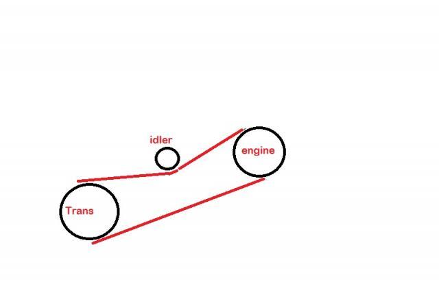

thomas 11 #1 Posted March 9, 2013 Took apart the Rj58 some tame back. Now I cant remember the bout the pulley takes abound the pulleys.. Any help or picture - appreciated. tooharley@aol.com Share this post Link to post Share on other sites
wallfish 20,733 #2 Posted March 10, 2013 (edited) The belt goes around the engine and trans pulleys with the clutch idler pulley on top of the top length of belt. The clutch pulley pushes down on the belt when the pedal is released. Edited March 10, 2013 by wallfish Share this post Link to post Share on other sites
