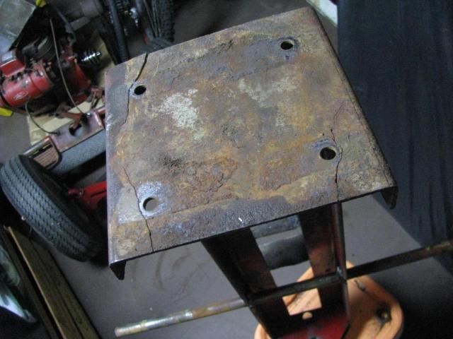

Kelly 1,038 #7 Posted March 8, 2013 Ramming snow banks is not good, but I think most of us do it, but that is what breaks the trans mounting plate at the back of the frame, many of the newer hitches have 1/4" pins to help hold the latches closed, you could drill a hole through the latch and mount to put a pin in, if your not sure what I'm talking about I'll get you a pic, I know you have the old style hitch and they never had the holes. Share this post Link to post Share on other sites

groundhog47 448 #9 Posted March 8, 2013 I was thinkin' this myself as there was a post on RS about the transmission plate be broken/stress cracked, where to get, how to fix. I didn't know how plowing could do that, but what we call plowing up here is turnin' over the soil. Thanks, now I know for sure how/what kind plowing fractures that plate...not a fun thing to discover. Like the idea of pins in latch ! Ramming snow banks is not good, but I think most of us do it, but that is what breaks the trans mounting plate at the back of the frame, many of the newer hitches have 1/4" pins to help hold the latches closed, you could drill a hole through the latch and mount to put a pin in, if your not sure what I'm talking about I'll get you a pic, I know you have the old style hitch and they never had the holes. Share this post Link to post Share on other sites
bitten 134 #10 Posted March 9, 2013 Might want to check and make sure you still have a dish shape on the lever for your hitch if not going to use the bolt cotter pin way. I have rammed with my dozer blades since I have had one and I might just be lucky but I haven't had any problems yet. The soil turning plow is mounted to the rear end and might be hard on the mounting plat as well. It is a good idea to reinforce the tranny mounting plat no matter what kind of plowing you are doing. Share this post Link to post Share on other sites

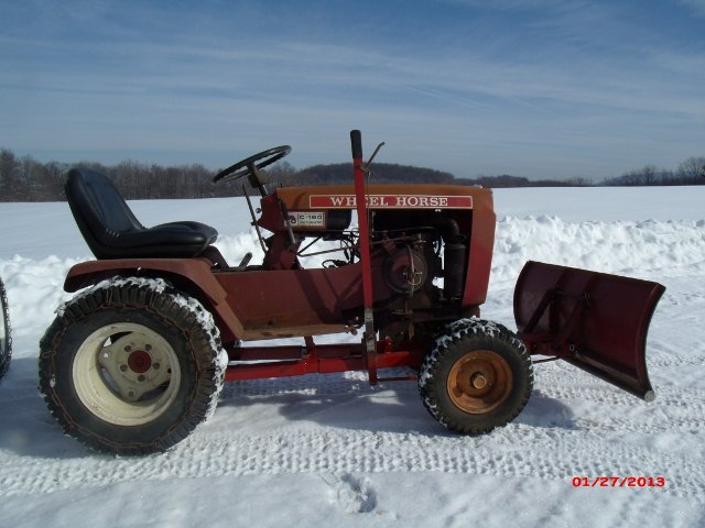

Foozerush 40 #19 Posted March 13, 2013 Hi all.... Thanks for your replies to this thread. I know now what the problem is that my latches do not have locking pins/holes pointed out by Kelley ( got the bracket from him ), so it sounds like an easy fix, when i pull the plow off and remove bracket I will "fab" a locking pin/holes myself.... I'll add some pics of the snow i had to battle, to show what piles i had to "ram" a bit to give me all the INCHES of my 2 car wide drive i need for clearance for my truck and the van my wifey drives, TRUST ME i need all the room i can take, she has the knack of taking one of the side mirrors off one of them at least once a year because my drive could use widening. ( thats a whole new story) haha. Stuck on first pass without chains. Chained up!! The piles on end of drive looking down sidewalk. Letting her cool off in driveway. I do not ever intend to ruffle feathers when asking a question..... I do have a soft spot on chains leaving marks on drives/ sidewalks, dont like it.... i run chains when i need too, i feel my horse is heavy enough to push what it can with out them, I dont have a whole lot to plow, do more than my fair share on the sidewalks in my hood for seat time, but with that last heavy snow, had to chain up. I think I might budget another set of rear tires and have them filled and keep the chains on and just swap em out at winter time, but the only thing holding me back is storage, garage space is premium here. Thanks All. Gregg Share this post Link to post Share on other sites
