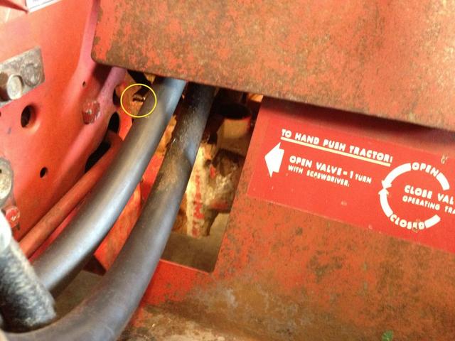

EZRYDER 1 #1 Posted March 6, 2013 I have a C-121 with automatic tranny that cannot be rolled unless a valve is opened on the tranny. The problem is that the valve consists of a 5/16" square cap on a bolt that I find nearly impossible to access. I can get to it with some difficulty but the is not enough room to get a ratchet socket over it and not enough room to even maneuver an open end wrench to get it loose. It is wedged in behind the left rear tire and there are a lot of brackets and things around it. Any help? Larry Share this post Link to post Share on other sites
Martin 2,133 #2 Posted March 6, 2013 (edited) i think the c121 has a piston to piston version sundstrand, much like the c160 of mine........ the main difference i suppose between the c160 and c121 in this area would be the extra cover and slightly different running board on the left of the hoodstand that would make it hard to get in there. i find accessing the c160 tow valve a bit of a hassle, but it has a slot and not like you described. i just use a very long thin screwdriver between the hyd lift hoses and turn it. the valve shouldnt be tightened up that much that it is so hard to turn. heres how mine looks....... could you get to it from underneath with a long handled ratchet and socket? maybe theres more room than from the side? sorry i cant come up with a better plan, i dont have a c series auto the same model as yours. i have a couple of tractors that have similar sheet metal, but they are 8 speed or later eaton autos and i can imagine it would be difficult without the same sort of access that the c160 or similar tractors have...... Edited March 6, 2013 by Martin Share this post Link to post Share on other sites
EZRYDER 1 #3 Posted March 6, 2013 Thanks Martin, I wish I had the access as shown in your pic. I can't even get a socket over it because it is wedged against a body part.and it has no slot. I guess I need to get it on a lift so I can get under better and try to fashion some permanent tool for it. I can't be putting it on a lift every time I need to roll it. The garage is under the house so we smell all exhausts so I would like to roll it out before I start it. Larry Share this post Link to post Share on other sites
