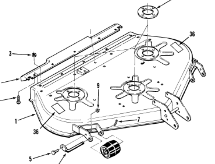

TT-(Moderator) 1,173 #4 Posted March 6, 2013 The 42" RD deck (05-42XR06) that was on my 1986 YT12-A had that deflector. (p/n 109038) It helped keep the clippings off of the inside of the rear wheels. Here's the drawing: Share this post Link to post Share on other sites
Stormin 9,988 #5 Posted March 7, 2013 That's like I had in mind. More or less. Thanks, Terry. 1 Share this post Link to post Share on other sites

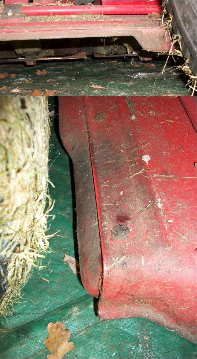

wheeledhorseman 579 #9 Posted March 7, 2013 Here's the photos of mine... (click to enlarge) I've never really given it a great deal of thought - it's just been there on this deck. Looking at it I can see that it's designed to direct the grass out between the rear wheels. However, cutting a field the deck's always on its highest setting and if the grass is wet the tires still get covered in the stuff. Must help a bit I guess. Andy 1 Share this post Link to post Share on other sites
Stormin 9,988 #10 Posted March 7, 2013 Some kind of extension between the wheels might help keep the grass off the wheels at max height. And as I typed that another idea reared up. Going to have to get some cardboard sheet to make mock ups. Share this post Link to post Share on other sites
