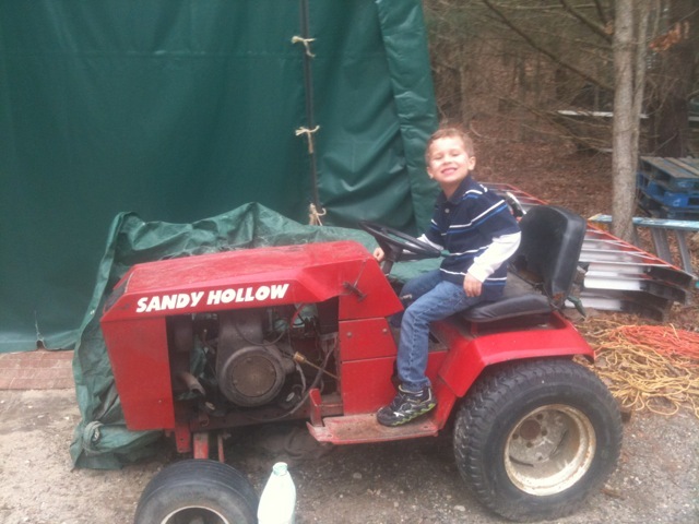

greenmonster304 0 #1 Posted March 4, 2013 Hi, I am new to the forum. I just got this tractor given to me and I wanted to fix it up a bit for my son to play with. I am not sure what model it is. Share this post Link to post Share on other sites
GlenPettit 1,714 #2 Posted March 4, 2013 Looks like a C-125: C-85 ( < this is a C-125) Probably 1980, 12 hp, 8 hp. Your rear fender may have been changed(?), trainee looks ready & eager to learn. All your manuals are a free download, basically any implement from '73-'08 will fit. Nice tractor. (Serial # may be under the dash tower or under the seat) (edit: 10:20am, I agree with Jim, smaller engine . . . )1980 C-125 8-speed #01-12K801 1980 C-85 8-speed #01-08K8011980 C-125 Automatic #01-12KS01 1981 C-85 8-speed #01-08K8021981 C-125 8-speed #01-12K802 1982 C-85 8-speed #01-08K8031981 C-125 Automatic #01-12KS02 1983 C-85 8-speed #11-08K8011982 C-125 8-speed #01-12K803 Share this post Link to post Share on other sites
jimt1971 236 #3 Posted March 4, 2013 With the 8hp Kohler it should be a C-85. Jim Share this post Link to post Share on other sites

greenmonster304 0 #5 Posted March 4, 2013 whats the story with the 8hp kohler? I have a 24 HP onan off a Case Mini Sneaker that I was thinking of putting on. do you think the drive train could handle the added power? Share this post Link to post Share on other sites
Lars 526 #7 Posted March 4, 2013 whats the story with the 8hp kohler? I have a 24 HP onan off a Case Mini Sneaker that I was thinking of putting on. do you think the drive train could handle the added power? My brother has one whit 24 hp onan on.. it works good but he had a c165 at the start.. not sure if you have the "strong" tranny.. whit 1-1/8inch axels and 8 pinn diff.. if not you have 1 inch axels and 4 pinn diff. Share this post Link to post Share on other sites
qd-16 14 #8 Posted March 4, 2013 You would be very surprised what that little 8 horse can do! Share this post Link to post Share on other sites
dsholler 54 #9 Posted March 4, 2013 as long as it runs OK, I would leave the 8hp in there for now.. then your son will use far less gas playing around with it. In a few years when he is old enough to want (read: is required to) do the yard work then he can help you put the bigger engine into it... Share this post Link to post Share on other sites

Sparky-(Admin) 19,683 #11 Posted March 4, 2013 whats the story with the 8hp kohler? I have a 24 HP onan off a Case Mini Sneaker that I was thinking of putting on. do you think the drive train could handle the added power? My brother has one whit 24 hp onan on.. it works good but he had a c165 at the start.. not sure if you have the "strong" tranny.. whit 1-1/8inch axels and 8 pinn diff.. if not you have 1 inch axels and 4 pinn diff. All the 8 speed Black Hoods came with the 1-1/8" axles and the 8 pinions. It'll be fine with an upgraded motor. Mike............ Share this post Link to post Share on other sites
