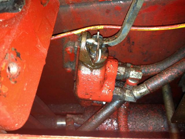

Machria 88 #1 Posted February 17, 2013 My lift valve part #8363 on my GT14 is leaking out the top (see picture). Anyone know where I can get a replacement, OR can it be repaired? Thanks... Share this post Link to post Share on other sites
meadowfield 3,191 #2 Posted February 17, 2013 Yes it can be repaired. The square section o ring seals can be removed and replaced. I overhauled mine last year... Share this post Link to post Share on other sites
Machria 88 #3 Posted February 17, 2013 Awesome, thanks. Where do I get the seal? Any special tools needed or just plain jane take it apart, put on seal and screw back together.... ? Share this post Link to post Share on other sites
meadowfield 3,191 #4 Posted February 17, 2013 I'm in the uk, so just went to a bearing/seals supplier and they had them in stock. The spool comes out by undoing the lock nut and screw at the bottom. Take care not to lose the float detent spring! Share this post Link to post Share on other sites
Machria 88 #5 Posted February 17, 2013 Thanks, you sure it was the same 8363 lift valve? I just found an O-ring kit for a lift vavle for WH, but it said it does not fit this "one piece lift valve". Share this post Link to post Share on other sites
meadowfield 3,191 #6 Posted February 18, 2013 yours looks like mine, a one piece casting with 4 ports in a diamond formation Share this post Link to post Share on other sites

meadowfield 3,191 #11 Posted February 21, 2013 I just took the old ones into a bearing shop, they measured them and got me some in after a couple of days. Share this post Link to post Share on other sites
pfrederi 21,274 #12 Posted February 21, 2013 I haven't opened my valve up yet, but, WH didn't make them they bought them. I would assume the O rings are a standard size. You could measure them and buy replacements at a good hardware store. Or look in the yellow pages for hydraulic service places. Just take your valve assembly in I am sure they can fix you up. (The more garbage trucks out side the hydraulic repair place the better!! ) Share this post Link to post Share on other sites
meadowfield 3,191 #13 Posted February 21, 2013 They are square section, otherwise it would be a very easy fix! Share this post Link to post Share on other sites
pfrederi 21,274 #14 Posted February 21, 2013 They are square section, otherwise it would be a very easy fix! Are they like the backer O rings used in the Sundstrands between the pump and the hydro motor?? In any event a hydro shop would have square rings as they are not uncommon in hydraulic land. Share this post Link to post Share on other sites
