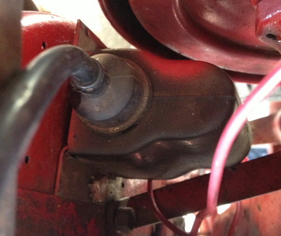

Machria 78 #1 Posted February 16, 2013 Hi, I'm trying to tune up me new to me GT14, which has the K321s motor in it, with the breakerless Ignition coil (at least that is what it looks like per service manual comparison). I tested the ignition coil per the service manual with a Ohm meter, and it is reading 10,500 ohms, the manual said it should "read about 11,500 ohms. It also said it should NOT show continuity between the ignition switch wire and the mounting bracket, mine does. So I assume I need to replace it. Where do I get this part? Thanks in advace for the help! Share this post Link to post Share on other sites
