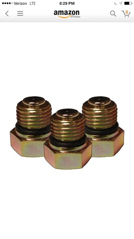

Aldon 4,834 #11 Posted October 6, 2015 (edited) Found these magnetic plugs on Amazon for Harley application. These are pricey but they also have them for as little as 10 bucks.Same thread as Hydro drain plug. Hs has anyone went this route?not sure they are short enough. Edited October 6, 2015 by Aldon Share this post Link to post Share on other sites
shallowwatersailor 3,222 #12 Posted October 6, 2015 I have both Dimple brand and Gold Plug magnetic on my tractors and vehicles. You would be surprised at what they pickup even though there is a filter. 1 Share this post Link to post Share on other sites
