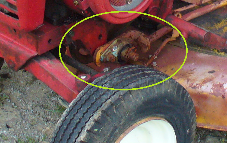

TT-(Moderator) 1,173 #3 Posted February 13, 2013 :WRS: I had good intentions of looking at mine earlier, but I never made it to the shop. Mine has had "generic" two bolt flange mount bearings installed - similar to these: http://www.surplusce...name=powerTrans The only bearing assembly I have found that's close to the original in appearance is made by Dayton (1A402): http://www.drillspot...ed_ball_bearing I did find a not-so-good picture of mine: Share this post Link to post Share on other sites
