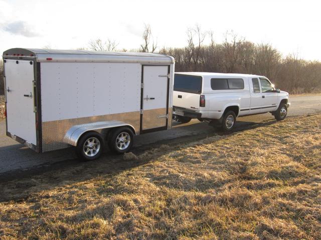

My New Horse Hauler... Enclosed 6x12
Don1977
The way I would check to see if you have enough  clearance is to hitch up the trailer and jack  up one trailer axle.  Not sure what type of pivot you have between the springs.
With the center pivots as you jack one axle the other goes down you can also tell have much difference in height between the axles.  On my utility trailer I have 3" of travel and can cross a 6" high curb and have all four wheels on the ground.
stevebo
Here she is hooked up to the puller. I did as much as I could at this point. When the weather gets warmer in a month or more I will coat the roof and most likely paint the sides white after doing some bodywork to fix the dents. I think the position of the fenders are fine as well :bow-blue:
