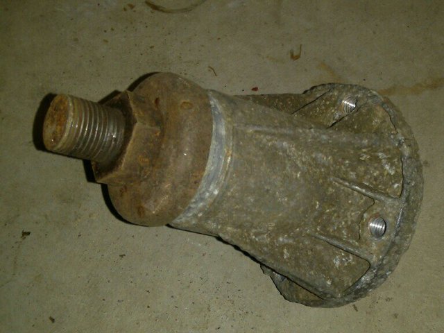

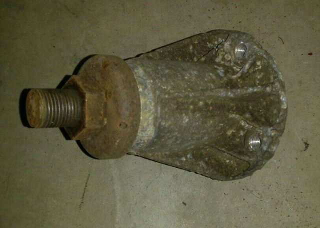

Trouty56 568 #9 Posted February 10, 2013 Seems they really corrode on the side the clippings and stones hit. The one on the left is usually in good shape. I am taking 3 off of a deck now. The pulleys are already junked but one or two housings may be of value to you. I can take a couple pictures if you like when I get them off. Share this post Link to post Share on other sites

Trouty56 568 #13 Posted February 11, 2013 Here is one of them. Share this post Link to post Share on other sites
thehorse 225 #14 Posted February 11, 2013 Looks way better than what's on mine! Interested! Does it by chance have a brother? Share this post Link to post Share on other sites
Trouty56 568 #15 Posted February 11, 2013 Let me get the other ones off....there is one that is better than this. This was the center one. I'm putting the double D type spindles back on. Share this post Link to post Share on other sites
