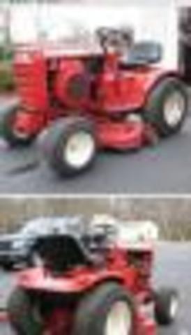

Wheelhorse84 87 #1 Posted February 6, 2013 So I just picked up a beautiful C-141 today. While I had the rear jacked up for my chains I noticed the left axle dripping oil. When I grabbed the wheel I notice some back and forth play. Is this a hard fix am I going to have to open up the UNI drive? I was hoping to plow Fridays storm with it will it due serious damage if I use it? Thanks guys. Share this post Link to post Share on other sites
rmaynard 17,642 #2 Posted February 6, 2013 When you say back and forth, do you mean in and out, or up and down? If it is in and out, up to about 1/8" is normal. If it is up and down or side to side, that usually indicates a bad bearing and will require opening up the transmission. Nice looking C-141. Share this post Link to post Share on other sites
Wheelhorse84 87 #3 Posted February 6, 2013 Side to side so I guess I'm gonna have to preform surgery. Share this post Link to post Share on other sites
