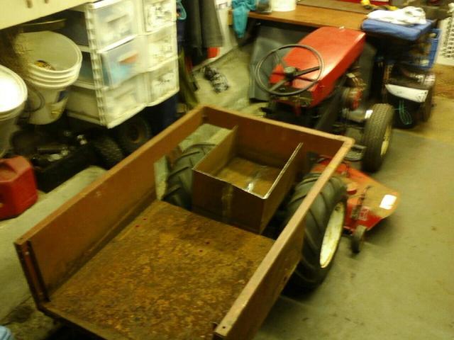

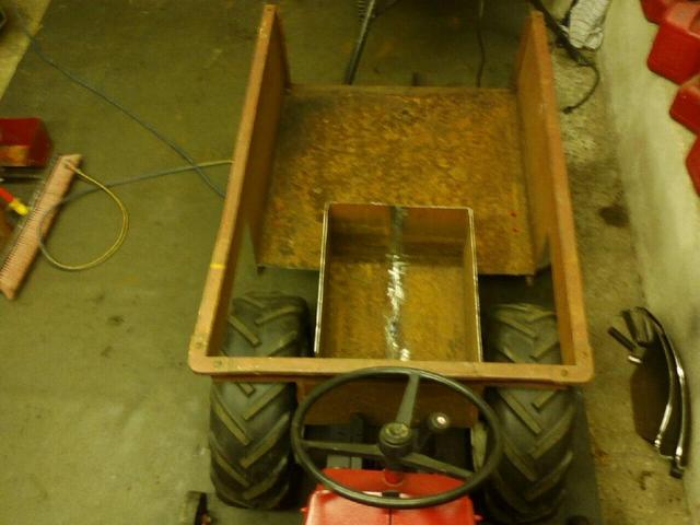

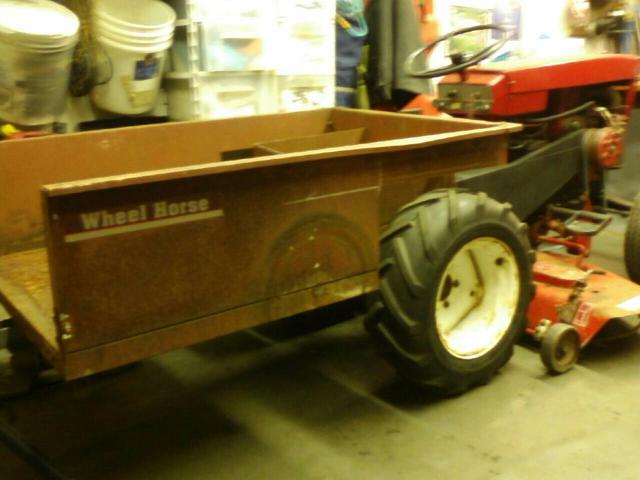

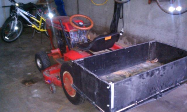

HorseWhisperer 243 #1 Posted February 4, 2013 Was workin on one project,set my adult bevie down and thought this up just now.Should I fab some inner fenders and a seat perch and finish? 1 Share this post Link to post Share on other sites
Irv 115 #2 Posted February 4, 2013 Looks like it would be handy around the yard-go for it! 1 Share this post Link to post Share on other sites
Tim 97 #3 Posted February 4, 2013 (edited) i like it.. but you will need some counter weight, I did this and with any significant weight (`250 lb) it will come off the ground without front weights i run at least 75 lb in front you will have more of a moment arm than me so it will need even more weight Edited February 4, 2013 by Tim 1 Share this post Link to post Share on other sites
roscoemi 245 #4 Posted February 4, 2013 Hmmmm.. A WheelHorse pickup. Any thought about extending the wheelbase back and maybe out a bit? There would be no need to counter weight the front, and adding a fabbed hitch to pull a trailer would make for alot of stuff moved in one trip. 2 Share this post Link to post Share on other sites

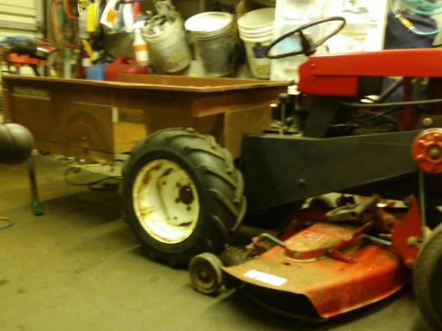

HorseWhisperer 243 #8 Posted February 5, 2013 Thats alot of yays.I done run myself out of gas tonight for the welder so I hanging it up.I ran two sticks of 2" angle right up to the dash tower,bolted it to the frame.Then I mounted a 8" piece of 2" square stock on the two rear end mount holes on top.I then welded it all together leaving the angle long coming out the back,Its strong and solidifies the rear to the chassis too.It will all unbolt and swap back to naked in a couple curse words! Share this post Link to post Share on other sites

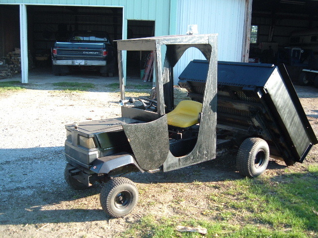

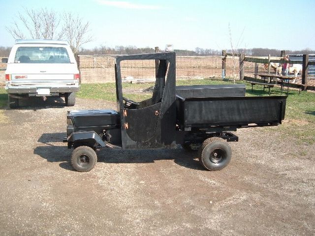

546cowboy 302 #11 Posted February 5, 2013 (edited) I did do something like that about 6 or 7 years ago but not with a Wheel Horse( just couldn't do it to a good Horse) I used two Craftsman frames bolted together, a fabricated dump bed ( made from a gravity grain trailer) and a plywood cab. Like I said this wasn't a Wheel Horse but it did look cool. Edited February 5, 2013 by 546cowboy 10 Share this post Link to post Share on other sites
prondzy 3,891 #12 Posted February 6, 2013 To make the front end stay on the ground have you thought of adding a second axle and ag tires like you got on already maybe midway down the box that would look pretty awesome too. Share this post Link to post Share on other sites

HorseWhisperer 243 #14 Posted February 8, 2013 I did do something like that about 6 or 7 years ago but not with a Wheel Horse( just couldn't do it to a good Horse) I used two Craftsman frames bolted together, a fabricated dump bed ( made from a gravity grain trailer) and a plywood cab. Like I said this wasn't a Wheel Horse but it did look cool. That looks like a whole lotta fun!Nice job!The product of a few amber pops? Share this post Link to post Share on other sites

neil 2,416 #19 Posted February 9, 2013 would a seat sping from a round hood fit so that you didnt have to cut anything off the front of the trailer tub, & do you intend to put any wheels on it to hold the back end ? great job, Love the concept Share this post Link to post Share on other sites
HorseWhisperer 243 #20 Posted February 9, 2013 would a seat sping from a round hood fit so that you didnt have to cut anything off the front of the trailer tub, & do you intend to put any wheels on it to hold the back end ? great job, Love the concept I wanted to add a tag axle Neil but I would have to have it articulate and support.I wish I had that kinda time!I can only hope an epiphany comes to mind! Share this post Link to post Share on other sites
