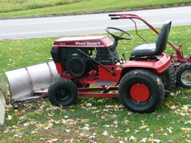

thehorse 225 #1 Posted February 4, 2013 New to me 416-8. Needs some TLC but should be fun for the boy to run once the 1000 little problems get fixed. 2 Share this post Link to post Share on other sites
TT-(Moderator) 1,185 #2 Posted February 4, 2013 :WRS: "neighbor". Is the Prime Sirloin Buffet still down there? Your tractor looks pretty good from here. You know we're going to want more pictures of that blade, right? Share this post Link to post Share on other sites
thehorse 225 #3 Posted February 4, 2013 It is still there. A good friend of mine is the new owner. The blade was a fabri. by the previous owner. Stainless steel. He had quite a few hrs. making jigs to build it. I guess $ also. I will put pics on when I figure out how to do so. I was able to put this on because it was the online pic for the ad when I bought it. Tried to put pics of my 314-8 on yesterday for hrs to no avail. I decided to quit trying and have a few beers and run the gas out of the tank. Sounds like a tank to....muffler all rusted out. Share this post Link to post Share on other sites
855ownerJoel 32 #4 Posted February 4, 2013 Nice ride, I have a 414-8, those 8 speeds are sweet. That plow looks huge! Plenty of parts still available for that one. Share this post Link to post Share on other sites
thehorse 225 #5 Posted February 4, 2013 Thank goodness......I need plenty. Any advice on a cheap muffler alternative would be appreciated. And thanks for the comments. I figured my son could make a few dollars with the plow and 36rd deck I have extra. Then I don't have to cringe when he gets on my 314-8. Share this post Link to post Share on other sites

leeave96 496 #11 Posted February 4, 2013 I think you've got a keeper there! 16hp, Kohler Magnum (read cast iron engine with electronic ignition vs points/condenser) and tough 8 pinion/ 1-1/8 inch axles. You also got the final Wheelhorse sheet metal, but with Wheelhorse red, vs Toro/Wheelhorse decals and Toro red - not that the Toro logo makes anyone's (including mine) tractors inferior in any way, I just like the bright red and big Wheelhorse hood decals on that series tractors. Good luck, Bill Share this post Link to post Share on other sites

Wishin4a416 2,610 #13 Posted February 5, 2013 Nice machine. I saw that advertised. But forget where. Looks like there is plenty to work with. Share this post Link to post Share on other sites
thehorse 225 #14 Posted February 5, 2013 Punxy. Honestly lots of little stuff...mule drive, fashion a muffler, belt, springs, some sanding and paint, lots of missing nuts and bolts. HEY...the seat only has one tiny rip!!!!!!!!!! headlights work, no tail lights though. Little idiot lights on the dash are missing red lenses and they don,t seem to work anyways. I should screw some stuff up along the way but that's the only way I learn...that and pestering people on forums! Share this post Link to post Share on other sites
Wheel-N-It 2,978 #15 Posted February 5, 2013 You have got a keeper. The 416-8 with the big Kohler single is one tough hard pulling little tractor. You have a good pair now to keep for many years. I do recommend pulling the fuel tank and giving it a good cleaning at the car wash. Also replace the fuel lines and install a fresh filter. Remove the carb, scrub the fuel bowl till it shines, pull the two adjustment screws along with the float and needle. Give all that a good cleaning with spray brake cleaner. Now your fuel system is clean, and you can concentrate on the other stuff like paint and nuts and bolts and transmission oil. If you keep up with the 416 threads, you will notice alot of RS members want one of these tractors. There is good reason for that. Congragulations on your new purchase. Share this post Link to post Share on other sites
