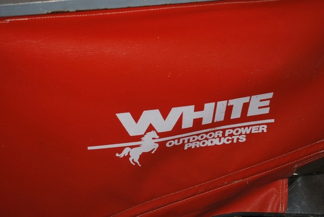

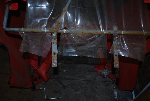

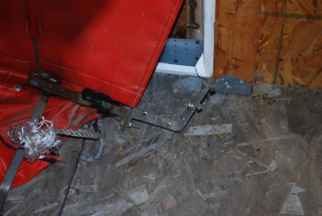

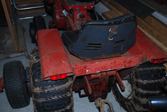

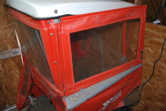

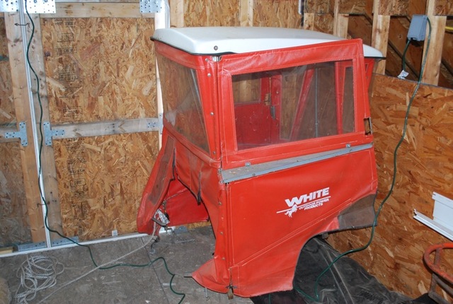

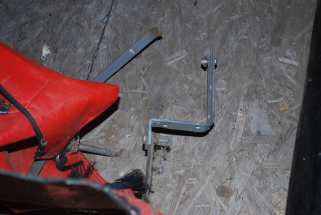

Indy443 30 #7 Posted February 8, 2013 Hi guys, I have been exchanging a few emails with a guy who had originally listed the cab on CL. I said I was looking for the cab that was intended for the 312-8. He said he had another cab that he was using on his GT-14. He'd made some adjustments to the cab to fit that tractor. Anyway, he sent me some photos of the cab, and I'm wondering if you think this would work on the 312. I have no experience with a snow cab so I do not know how they mount, or whether it's worthwhile to make one fit regardless. Will the brackets he has on the cab to fit his tractor bolt right up to the floorboards of the 312? It's also not a Wheel Horse cab, so I can't cross reference a model number to see if it will fit my tractor. Thanks for taking a look- Share this post Link to post Share on other sites
Kelly 1,038 #8 Posted February 8, 2013 I Think the first cab would be a closer fit, in fact it should not be to far of from being a good fit, they have very close body styles/ Share this post Link to post Share on other sites
cheesegrader 436 #9 Posted February 10, 2013 The White cab looks like it will be short in the back. The mounts to the footrests also look a little short, but that could be fixed. The big problem is going to be getting over/to your gas tank. The 300/400/500 series cab hangs over the rear fender by a few inches to cover this area. THe canopy supports angle back in at 45 degrees beneath the seat to make it back to the mounts bolted under the seat. This makes it easier to get to the tank and refuel. Modifying a shorter cab might make getting to the tank difficult. Share this post Link to post Share on other sites
