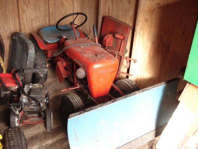

pinecone 26 #16 Posted February 3, 2013 planned to check this old guy out. was wondering arout the rear tires. same tread. any idea what year and model it is, would like to be prepared a bit when i call. the add only said "red". hope the photo comes out. i have not posted 1 yet. Share this post Link to post Share on other sites
TT-(Moderator) 1,129 #17 Posted February 3, 2013 any idea what year and model it is That's an RJ-58 / 59 (1958/59) All of the tires look to be newer replacements. Many manufacturers had that tread design available back then, and there were even some Wheel Horse branded tires in that style. 1 Share this post Link to post Share on other sites
