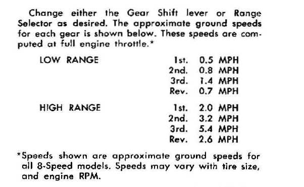

Anyone know if Wheelhorse ever published the ground speeds for the 8 speed, 8 pinion Unidrive transmissions? I've seen gear ratios but not ground speed for each gear (high and low range) at 3600 rpms.

I don't recall of ever seeing mph listed for each gear/range, but low 1st is .5mph and high 3rd is 5.5mph according to three different brochures I have.
With that information, ground speed can be calculated for the remaining gears/ranges using the ratios listed in the tranz manual.

rmaynard
It's published in my B-100 manual
leeave96
Very helpful info. I downloaded some later model manuals too (not at home to look at mine) and similar info was there too.
Thanks again,
