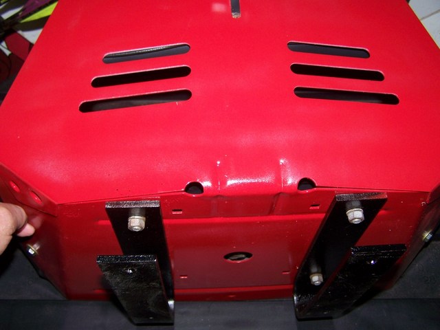

varosd 1,185 #1 Posted January 28, 2013 taking apart the $10 flea market find WH seat (sorry for the poor pictures..too much Dunkin D) looks like a mouse went up through the drain hole and hollowed out a pathway and there was multicolored yarn/string! So the missing foam, I'm just gonna cut pieces rather than try to peel the foam from the vinyl. the vinyl seat has 2 pinholes but otherwise is good condition. the seat pain has 4 coil springs? not like my B-80 seat. rusty and will need to saw the bolts off and fix the cracks at the holes. rust removal will be the trusty E-tank if we get a warm day to place it outside. not sure what seat bracket this was off..200 series? 1 Share this post Link to post Share on other sites
Sparky-(Admin) 26,625 #2 Posted January 29, 2013 I dont recognize that seat mount....maybe a rear engine rider ? Mike...... Share this post Link to post Share on other sites
TT-(Moderator) 1,183 #3 Posted January 29, 2013 You nailed it, Sparky Mike! There's a 108-5 with the same seat & mount at a local mower shop. Share this post Link to post Share on other sites

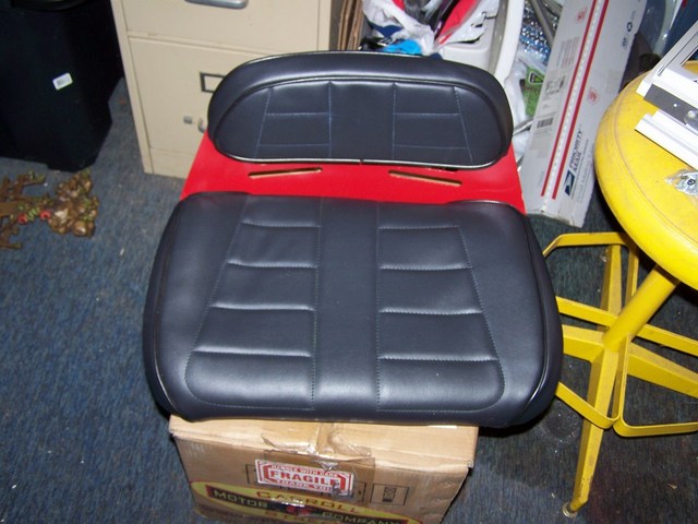

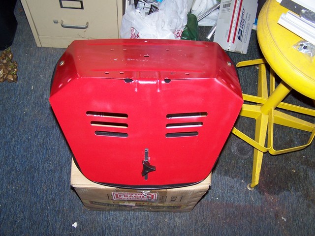

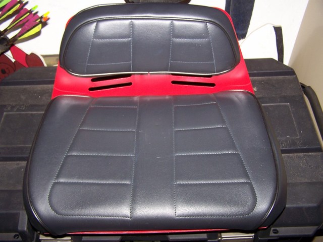

546cowboy 302 #10 Posted October 5, 2013 (edited) I just had two of those two piece seats recovered a couple weeks ago at a local upholstery shop. You have to realize they will never look original as the details on the bottom cushion and the logo on the back cannot be duplicated. They are like branded in there. I have to say it was not cheap to have them recovered but I think they did a real nice job. Since I have to get rid of everything I have posted them in the classifieds here. Edited October 5, 2013 by 546cowboy 1 Share this post Link to post Share on other sites

546cowboy 302 #12 Posted October 9, 2013 The seat back adjusts up and down and yes those ribs and the logo on an original are branded in there ( a heated metal stencil is lowered onto the material ) where these are stitches. The material on these seats is a heavy grade and will last for many years. Let's see a picture of your seat, are you sure it is original? Share this post Link to post Share on other sites
