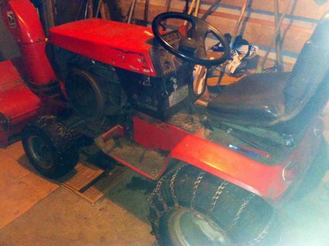

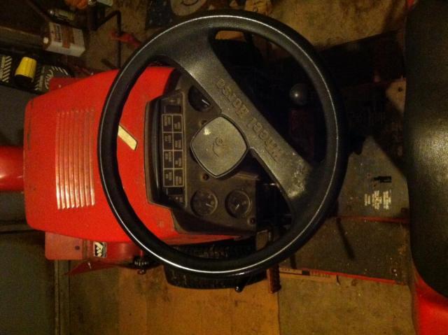

bobbyp109 0 #1 Posted January 27, 2013 I've been reading all the great info here and it's very helpful. I'm pretty sure I have a 520H but, can't find tags anywhere. I've searched all the places mentioned, still nothing. It's got the Onan P220, speed controller between the legs, 48 inch side discharge (numbers on deck said it was made 87/88) but things don't always seem consistent with others I'm seen and read about. I'd like to know the year or maybe somewhere else I might find a tag. Mine also has 8 test lights in the dash with the switch to test (left side is lights switch right side is test switch) if this helps. The front axles go slightly forward but, not like some I've seen for the 60 inch deck (newer TORO models I presume). The decals have also come off the hood, only the side HYDRO decals remain. This baby sat outside a while before i got it and someone painted some of it. Any help is much appreciated. Share this post Link to post Share on other sites

546cowboy 302 #5 Posted January 27, 2013 Welcome to Red Square! If the motion lever is between your legs it has to be an '88 or '89' 1990 and later had the motion lever on the right of the steering wheel and the lift lever on the left side. The swept forward axle is very noticeable and was on the 1990 and newer 520's. The model tag was on the seat pan just left of the seat track and was a paper tag. Share this post Link to post Share on other sites

bobbyp109 0 #8 Posted January 28, 2013 Wow, thanks for all the quick responses. I bought this WH from what was supposed to be the original owner. He said it came originally with a 20HP Koehler that burnt up within the first 200 hours and the dealer replaced it with the Onan. Have any of you heard of this? I love this machine and also have a 42 inch snow blower. It mows anything and sure moves the snow. I just turned 600 hours on the last storm. It looks just like the 1 pictured below with the blade on it (just yours is in better condition). Share this post Link to post Share on other sites
Sparky-(Admin) 26,686 #9 Posted January 28, 2013 (edited) It never had a Kohler on it, so if it is a replacement motor its exactly what it originally came with. Looks like a straight axle to me so its an 88 or 89. The model# tag was a decal on the fender pan. Most of them have worn off or faded to the point where it cant be read. I dont think there is a difference in the 88 or 89 models so you should be able to use either model# when looking up parts. 1988= 31-20OE01 1989= 31-20OE02 Mike................ Edited January 28, 2013 by Sparky Share this post Link to post Share on other sites
