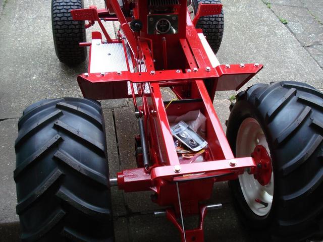

Anglo Traction 761 #14 Posted January 28, 2013 (edited) I only have a similar image of the Clutch Spring layout on an Earlier Model, but is the same principle. Can't help with the Gas Damper Strut, Hope it helps some.....click on image to increase detail- Edited January 28, 2013 by Anglo Traction 1 Share this post Link to post Share on other sites
