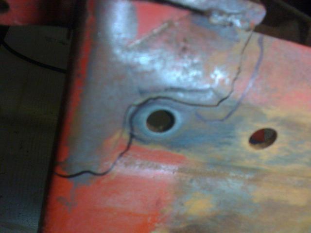

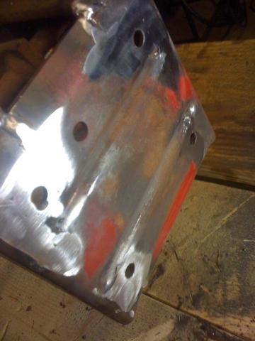

Callen 64 #1 Posted January 27, 2013 Had this So I did this and ended up with this Share this post Link to post Share on other sites

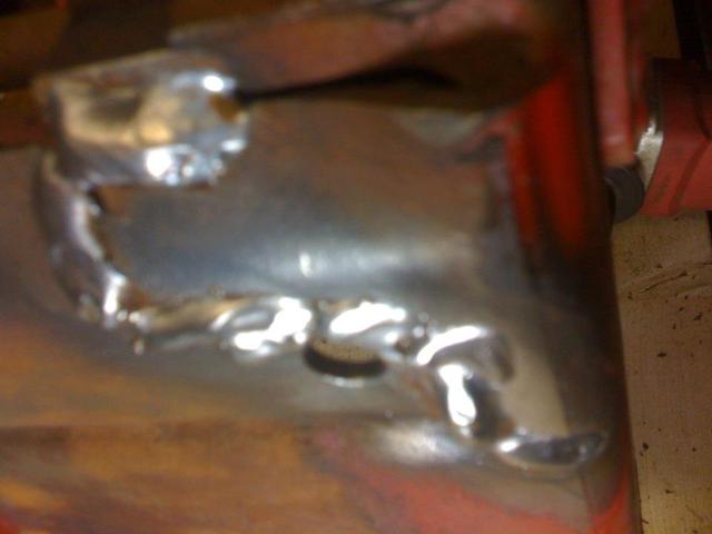

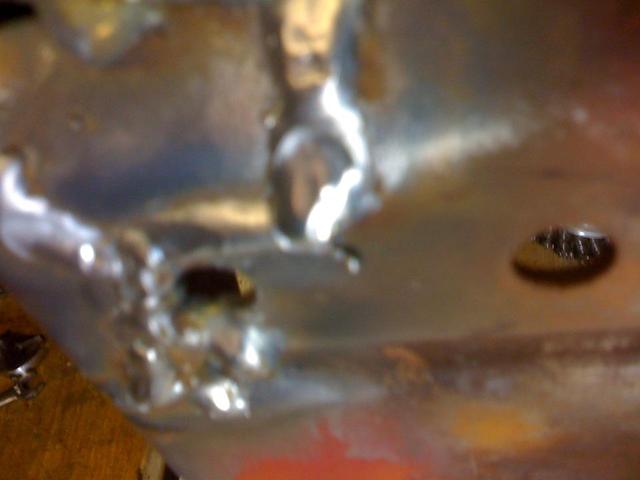

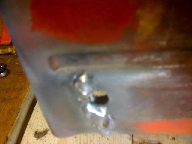

Callen 64 #2 Posted January 27, 2013 Gotta finish putting it back together. A little lacking in photography skills, Huh? Share this post Link to post Share on other sites
Don1977 606 #3 Posted January 27, 2013 Looks a lot better, did you add metal to the other side? Share this post Link to post Share on other sites
Kelly 1,038 #4 Posted January 27, 2013 Much better, did you weld the front side up? this is a somewhat common problem with WH. Share this post Link to post Share on other sites
KC9KAS 4,746 #5 Posted January 27, 2013 Looks like it will work....A lot of guys will add a 1/4" piece of flat plate steel to strengthen this common WH problem. Longer bolts will also be necessary. Share this post Link to post Share on other sites
Callen 64 #6 Posted January 27, 2013 I didn't do anything to the front. It was just a quick fix till summer. I have to get some plates made. Share this post Link to post Share on other sites
krazy_horse 59 #7 Posted January 27, 2013 Looks like it will be plenty strong. I have a couple that needs some welding. krazy_horse Share this post Link to post Share on other sites
Jake Kuhn 1,600 #8 Posted January 27, 2013 Great job on the fix. Looks great! :handgestures-thumbup: Share this post Link to post Share on other sites
