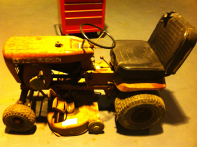

So I finally got started on my first ever restoration project.
My Lawn Ranger. I have wanted one of these for a very long time and when I finally found one I bought it without even seeing it, had it shipped over, and have looked at it ever since wondering where to start and what to do.
Well I thought the best thing to do would be to start to take it apart, which I have done.
I have included pics because I know you like pics and it should also help me put it back together.

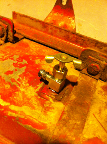

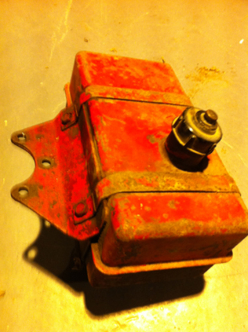

Firstly in the final photo in this first set, what is the metal outlet that appears to have wings? Is this for fuel? My engine and fuel tank do not have any fuel lines so I have to work this bit out.

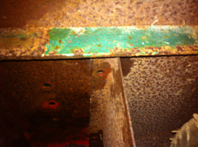

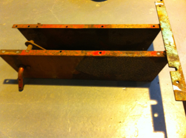

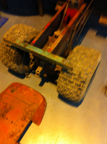

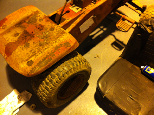

Then we seem to encounter a problem.
I have found a piece of metal which is green and not red.
I do not think this should be here.
The seat pan appears to be welded to this alien piece of metal which is being used as a support for the seat and seat pan.
Perhaps I am wrong, but it just doesn't appear to fit.
I had to break the welds to remove the seat pan, and continue with the dis-assembly.

The piece with the wings is a fuel shutoff. Nice commentary on the progress!

Your off to a great start, and with that set on the origional pisture, looks like the green metal was added for extra support. Heavy seat was put on that tractor.

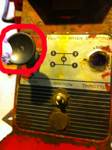

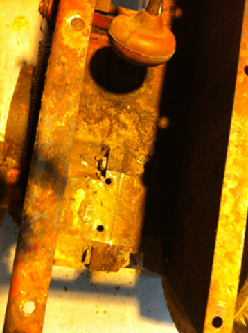

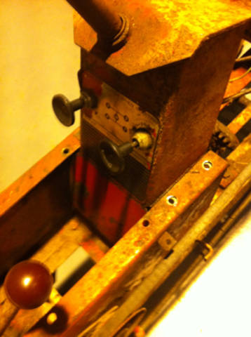

Firstly, as you can see in my first photo, I broke the choke knob. It was very delicate and I only tapped it against the frame and the side piece flew off. Is it easy to get a replacement for these? I will replace both, but need to ensure I get the right ones. I will also need a new plate for the dash, this one is beyond saving. The ignition bit does not look right to me either, should there be two holes?

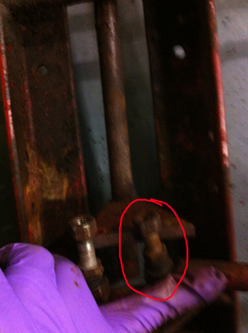

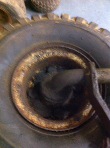

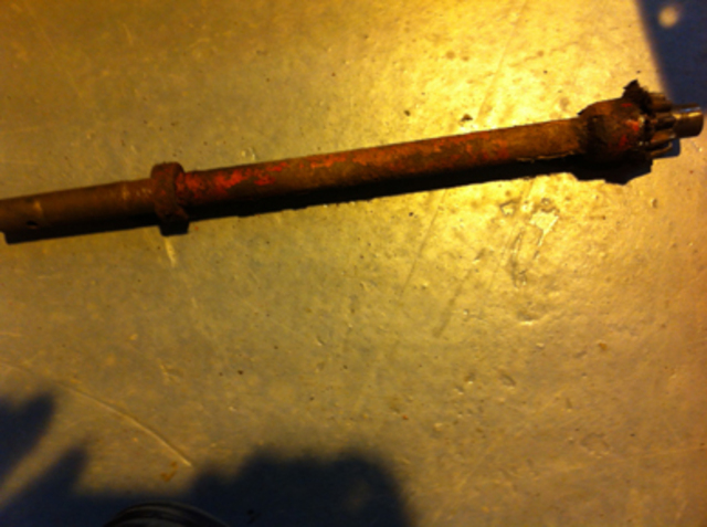

The steering mechanism was a little trickier to get off. I got the main gear removed from the chassis, but had no idea at all how to remove the small ball joint from the steering arm or from the link arms. I finally worked out a couple of them, but these must have been a little weak too, since one of the buts rounded off as soon as I touched it. So have to work out how to remove this one, will probably have to cut it. Are these easy enough to get hold off? I worked out that they do pop off, I assume they simply pop back on too? These are circled in the 5th picture.

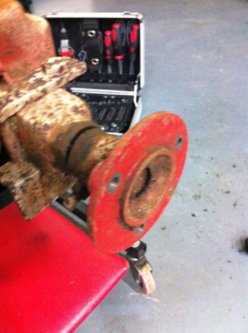

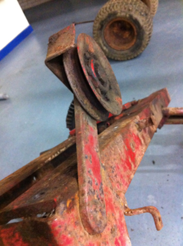

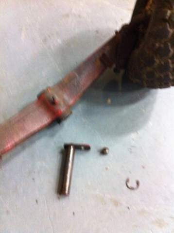

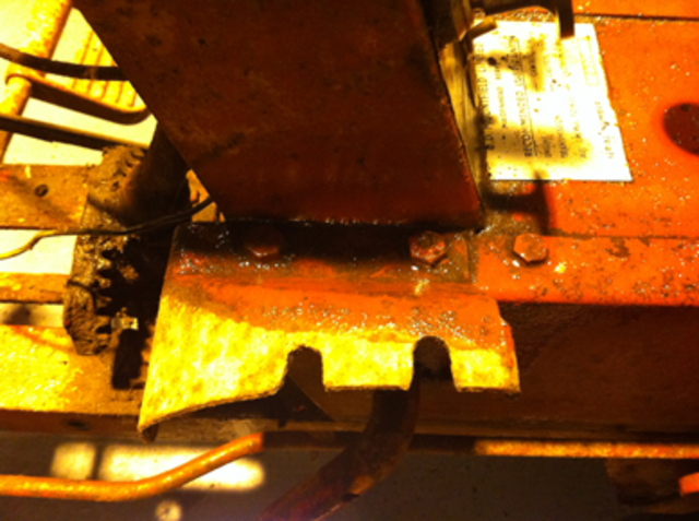

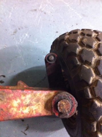

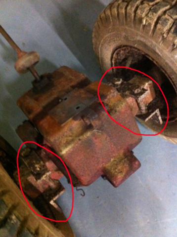

In the third photo, there appear to be clamps over both sides of the drive from the transmission to the wheel. Is this normal? Is it covering up some sort of damage? Should I remove it to find out?

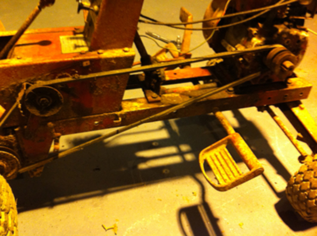

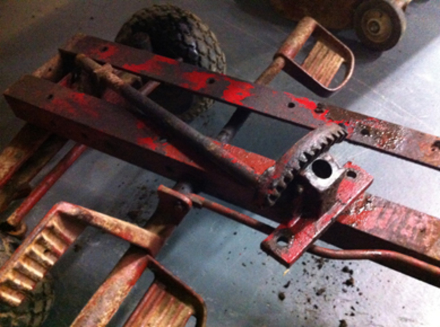

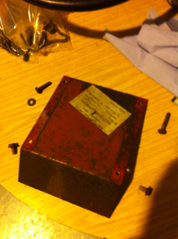

In the forth picture, I cannot work out how to remove this piece. Perhaps it is not meant to come out.

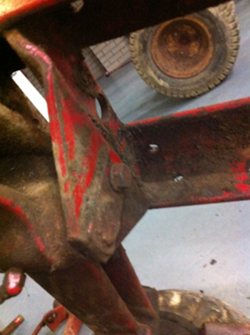

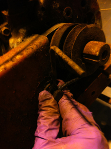

And finally, in the last picture there is a nut, but it does not seem to connect to anything. I spent ages trying to remove this entire arm, and cannot work out at all how to remove it, and this is where I ended tonight's work because it baffled me.

the choke cables as far as i know are fairly universal between the wheel horses. get one for a larger tractor and cut to suit. they can be had from toro or that online auction site. the throttle looks like its the same as the larger tractors, most people have trouble with the knobs twisting off with the new cables because of the locking mechanism. the choke doesnt have that and should survive longer. you could always look for something used as well.....
the tierods should unbolt from both ends of the tierod. they are replaceable as well, different lengths are available so make sure of the length you need. can be had online as well. or match up with good used ones.....
in the third pic those brackets are rear bracket mounts for a plow blade or tiller . they just unbolt, not needed if you are not using those attachments.
the belt idler arm in the fourth pic should have a removable clip on the other end of the shaft. (left side of frame) remove that and then just slide the shaft out of the frame....
in your last pic that is a bolt. it holds the axle pivot pin. unbolt the bolt, then there could be a clip (not sure on this model) on the front of the frame where this pin goes through the frame, remove that if its there, then the pin should slide rear wards out of the axle and frame (might require some persuasion). the axle will then fall out.....

Tierod ends: The "stud" part should have 2 flats on it so you can hold it from turning while undoing the nuts.
Lower Steering shaft: If you rotated it perpindicular to the chassis, the triangular shaped plate should come out from between the frame rails.
The clutch arm (Photo #4): I havent worked on a Ranger as new as yours, but if it is the same as the earlier roundhoods then the shaft is welded to the arm fitted with your idler pulley, and pinned to another arm on the other side of the chassis. Its a very small diameter rollpin (I'm thinking 1/8" diameter) and very often very difficult to remove. I have bent and broken many pin punches trying to remove these pins. Several times I have just cut the crossshaft to remove it, and then made a new one.
Martin
you know mike, id completely forgot that the clutch arms were pinned on some of the larger ones as well, i know i have memories of dealing with a rusty pin. i ended up grinding the pin flush on one of them and redrilling once it was out....sucks.....

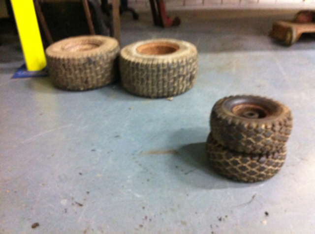

Managed to take all the wheels off without any difficulty. I think they may have a little life left in them yet. One of the smaller front wheels is flat, so I will have to see if I can get a new tube for it.
The rest have a few cracks around the walls, but should be grand for the little work I will be subjecting the Wheelhorse to.
