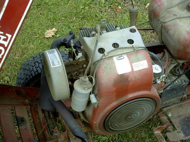

fourwheels0 191 #1 Posted January 23, 2013 if you buy an after market kohler or get a tractor with one in it ( a blue kohler ) be very careful and replace the starter bolts. i had one blow out and strip the threads. mind you the bolts only went into the first 2 or 3 threads. factory mistake. i put new longer bolts in and all is good. 3 Share this post Link to post Share on other sites
Sparky-(Admin) 23,988 #2 Posted January 23, 2013 Thanks for the heads up. I bet a few guys will be checking their starter bolts tonight. Mike........... Share this post Link to post Share on other sites

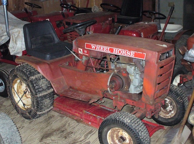

fourwheels0 191 #3 Posted January 23, 2013 hopefully this will help somebody out before they have an issue. the c-120 (pictured above) i recently picked up and it has an almost brand new 12hp on it but the wiring was a mess. good thing because those bolts weren't even close to being long enough. i think i started it 3-4 times and boom out came the bolt. Share this post Link to post Share on other sites

fourwheels0 191 #10 Posted January 23, 2013 TT thanks that clears things up for me on the different color kohlers. i always wondered about that. sousakerry2 this looked like it had never been apart. paint was not disturbed. both bolts matched and had the same amount of thread lock (albeit in the wrong place). they were just too short. maybe it was a "Friday" build and they ran out of the correct bolts lol. Share this post Link to post Share on other sites
