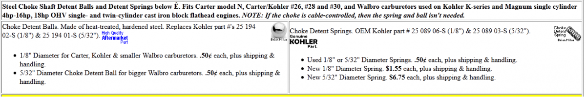

tunahead72 2,662 #9 Posted January 21, 2013 "NOTE: If the choke is cable-controlled, then the spring and ball isn't needed." Terry, can you explain? :dunno: Share this post Link to post Share on other sites
TT-(Moderator) 1,185 #10 Posted January 21, 2013 The detent ball and spring holds the choke shaft & plate in the open position. (against the vacuum entering the carb throat) If a control cable is attached to the arm on the choke shaft, the plate cannot unintentionally close. Share this post Link to post Share on other sites

JC 1965 1,549 #15 Posted January 22, 2013 The detent ball and spring holds the choke shaft & plate in the open position. (against the vacuum entering the carb throat) If a control cable is attached to the arm on the choke shaft, the plate cannot unintentionally close. I am rebuilding this carb for an engine I am going to use on a lawn vac. ( hopefully ) There will not be a control cable. I will be working the choke by hand. That's why I need the detent ball. :thumbs2: Share this post Link to post Share on other sites
