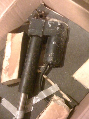

J3 Driver 1 #10 Posted January 23, 2013 I'm new here but I do have a C160-8 with the wheel horse electric lift option. Works real well. Will lift the snowblower, mower deck, roto-tiller, or anything that I have attached to the sleeve hitch. I have the manual around somewhere. I can scan it and post if you'd like. 1 Share this post Link to post Share on other sites
Butch 194 #11 Posted January 23, 2013 WOW!!! 1100 lbs of lift. Damn! Share this post Link to post Share on other sites
