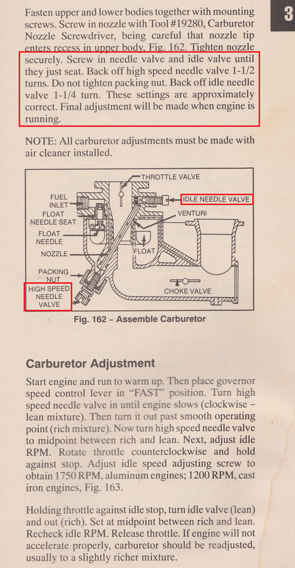

Bobie01 22 #1 Posted January 17, 2013 Hello horse owners I have a friend help with a Bolens G10 and has problems with his carburetor, sadly the engine is not running well. Wanted to ask what he said from a 10HP 1055-04.NowI if anyone has a manual or pictures or can I somehow with my problem, because I know not for what that screw is set to. Therefore, I would prepare myself even before it. Thanks Jeff Share this post Link to post Share on other sites
Bobie01 22 #2 Posted January 19, 2013 No help for me??? Share this post Link to post Share on other sites
roscoemi 245 #3 Posted January 20, 2013 Is the carb clean? Rebuilt? It needs to be clean, every hole and passage. Make sure the throttle shaft is not wore out and leaking air.Get the float set to the correct height. Run the mixture screws in until they lightly bottom out, then open them 1 1/4 turns. That should put you in the ballpark. Google the carb number for more information. Share this post Link to post Share on other sites
Bobie01 22 #4 Posted January 20, 2013 The Carb is rebuild but I don't find anything about that engine on Google?! I ask my Friend of a Picture of the Carb, so somebody can tell me which screw is for what there. Jeff Share this post Link to post Share on other sites
TT-(Moderator) 1,170 #5 Posted January 20, 2013 It looks like the G-10 should have a 251417 Briggs engine. (10hp) This should help with the carburetor questions: Here's a link to the manual for the tractor: http://sonnys_bolens...eframe/1055.pdf Share this post Link to post Share on other sites
Bobie01 22 #6 Posted January 20, 2013 Oh, many many thanks to you TT but also to roscoemi. That's why I love Redsquare.Unfortunately I have not found information, because the wrong data of my friends. But I also have not figured out what engine it could be,when I were just looking at google there was just verticalshaft engines so I thought the Number was wrong. Thanks a lot!!! Share this post Link to post Share on other sites
