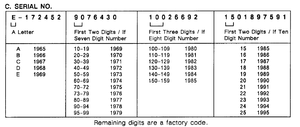

whc160 80 #1 Posted January 17, 2013 I would like to find out the years of my K341 Kohlers. Tried on kolher's site & I could not get anywhere. Here is one of the serial #s I was trying to use 6187491. Share this post Link to post Share on other sites
rmaynard 17,659 #2 Posted January 17, 2013 (edited) According to the Kohler service manual, in a 7 digit serial number, the first 2 digits in the range of 60-69 indicates 1974. Edited January 17, 2013 by rmaynard 1 Share this post Link to post Share on other sites
BOWTIE 226 #3 Posted January 17, 2013 I BELIEVE THAT WOULD BE A 1974. I HAVE A CHART THAT LIST ALL K SERIES. BOWTIE IN OHIO Share this post Link to post Share on other sites

BOWTIE 226 #6 Posted January 19, 2013 I HAVE GOT THE SAME CHART AS BOS. NOTHING PRE 65. BOWTIE IN OHIO Share this post Link to post Share on other sites
